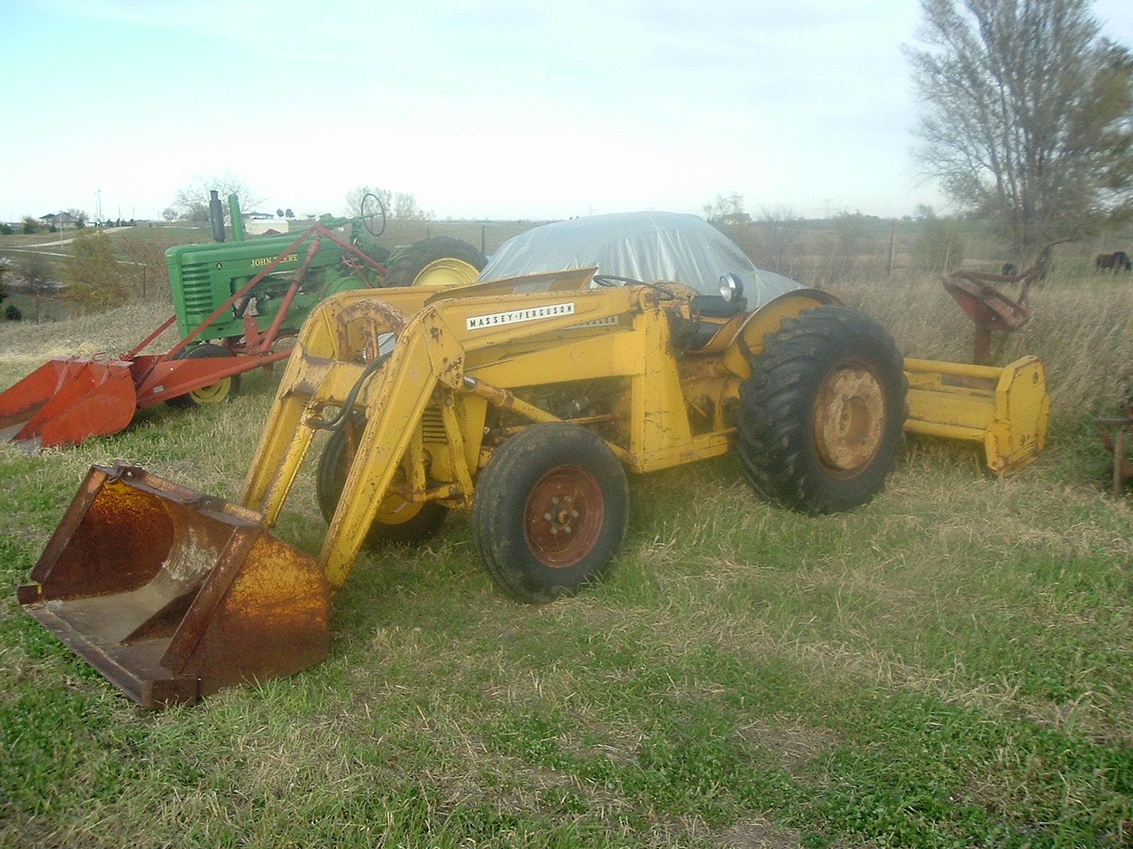

Thanks. Still haven't figured out how to get the hood open but I only spent a few minutes there today taking pictures. The first picture is of the tractor itself.

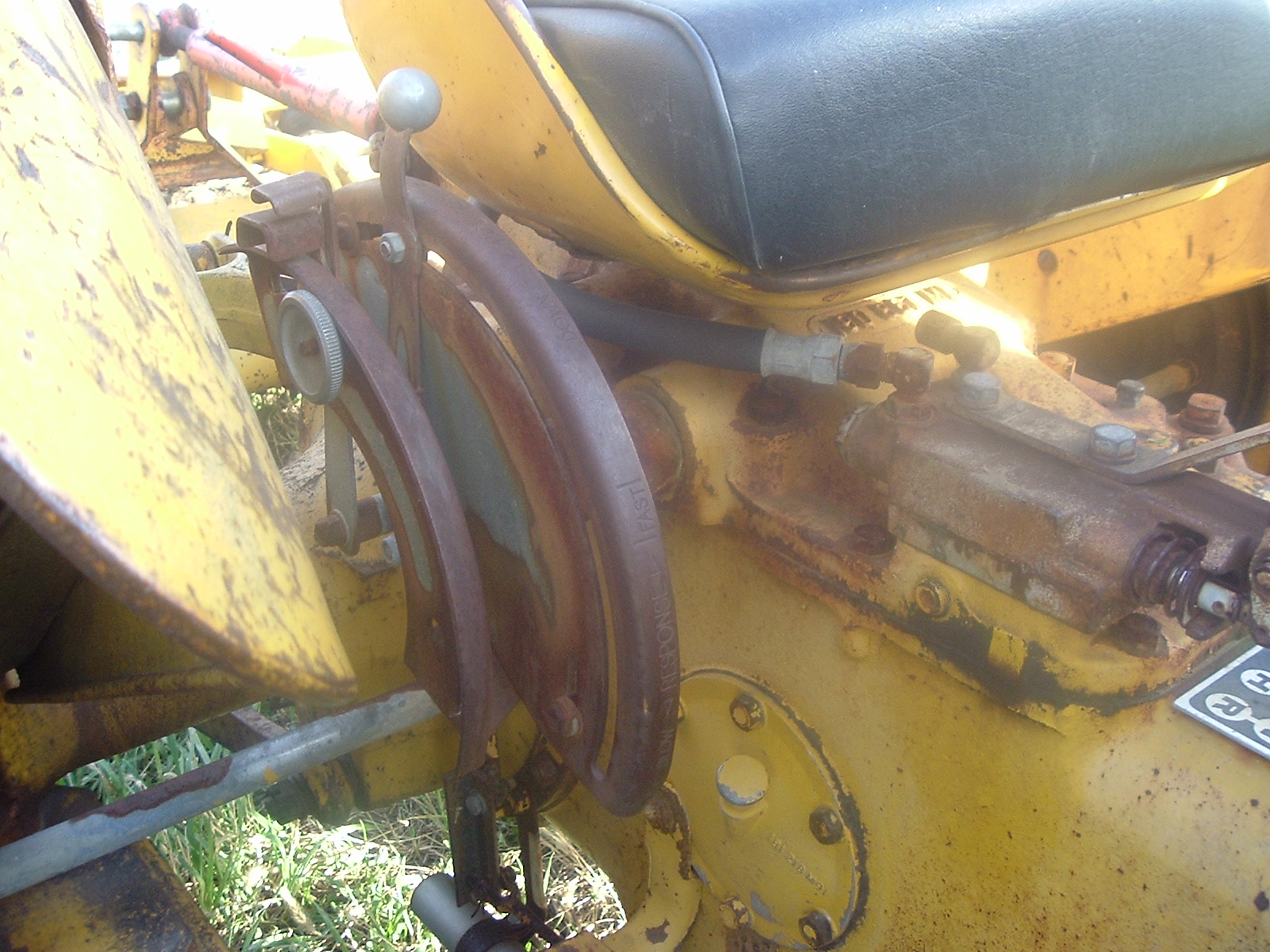

Second shows the pedals on the right side. I don't think there's a differential lock.

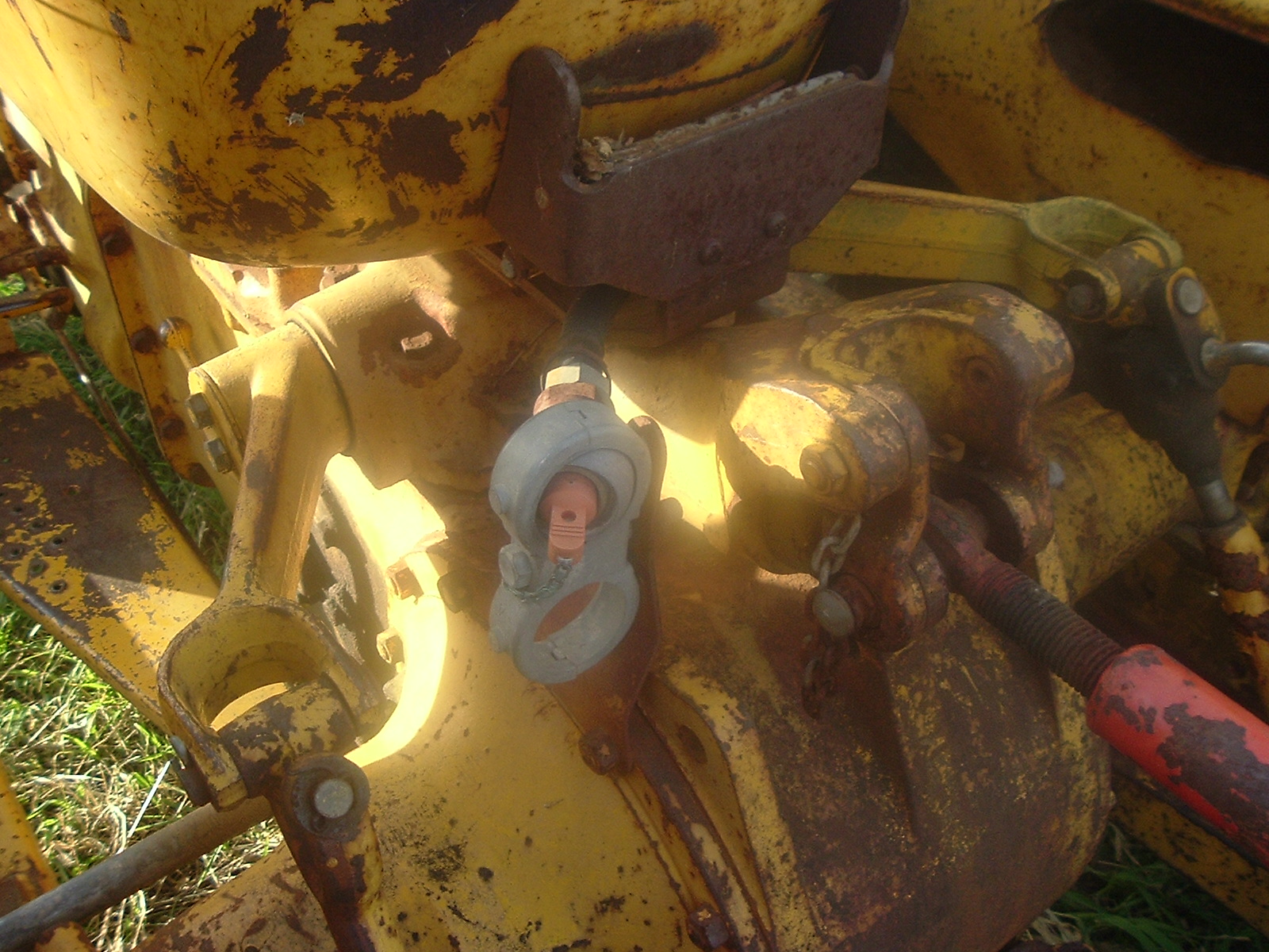

Third and fourth pics are of a hydraulic connector near the rear. I assume that's for operating a remote cylinder but am I restricted to single-action cylinder only? I only see one connector. Is one lever for 3-pt and one for the remote cylinder?

i dont think you have a diff lock, they are usually on the rh foot plate back near the diff. we didnt get this model in AUS but it looks a **** of a lot like the 35 we did get. you are going to have some serious fun getting the bonnet off. it tips forward, and i see you have a loader in the way. your best option is to undo the 2 securing bolts at the bottom of the bonnet at the front, then lift the whole thing off. take a friend.... the levers on RH side are 3pl (inner one) and draft (outer). push the 3pl lever all the way back and you get constant pump. this is sometimes used so remotes etc work. it depends on how the remoes are plumbed. i have seen so many different systems on these things i stopped trying to know them all, trial and error im afraid.

Ok first off that's an Industrial 35. The books will be different in certain respects for it vs a regular ag-35. Get all the info off of the data plate ,including where it was built before you go to the dealer. Might check on eBay also. Big Dean is the MF Guru.Big Dean web Site

Looks very similar to my MF 203 industrial tractor
