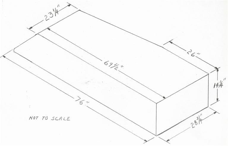

Aug 12, 2006 / MF#3 Baler #1 JJ. in B.C. Silver Member Joined Aug 9, 2006 Messages 139 Location BC. Canada I need a packer/knotter safety shield for a MF#3 baler, does anyone Know if a #9, #10 or #12 shield will fit before i hit the "old iron" yards. Thanks, JJ.

Aug 17, 2006 / MF#3 Baler #2 Birdman Silver Member Joined Jul 24, 2004 Messages 174 Location SE Indiana I can't answer your question but I have a MF#3 and can measure the safety shield if that would be of any help.

Aug 17, 2006 / MF#3 Baler Thread Starter #3 OP JJ. in B.C. Silver Member Joined Aug 9, 2006 Messages 139 Location BC. Canada Thank Birdman, that would be a big help.
Aug 20, 2006 / MF#3 Baler #4 Birdman Silver Member Joined Jul 24, 2004 Messages 174 Location SE Indiana Here are the outside dimensions, if you need any other measurements let me know. Attachments scan0001 (Large).jpg 24.5 KB · Views: 232

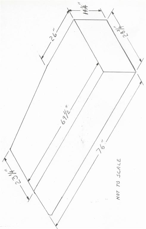

Aug 20, 2006 / MF#3 Baler #5 Birdman Silver Member Joined Jul 24, 2004 Messages 174 Location SE Indiana This one should be easier to view Attachments scan0001 (Large).jpg 24.3 KB · Views: 215
Aug 20, 2006 / MF#3 Baler Thread Starter #6 OP JJ. in B.C. Silver Member Joined Aug 9, 2006 Messages 139 Location BC. Canada Thanks Birdman those are great, i appreciate your time and effort. Now to find one!! JJ.
