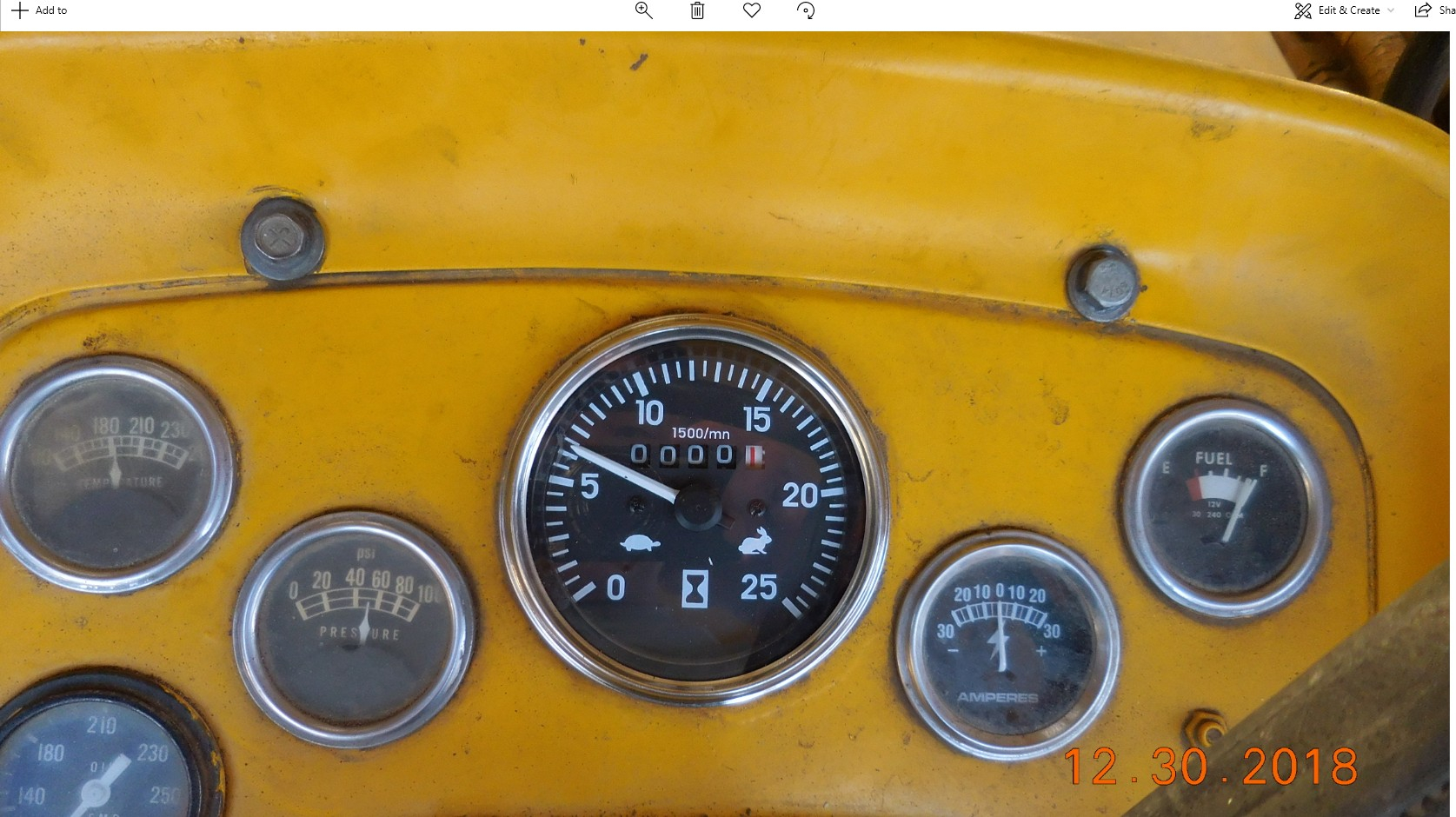

My MF 255 tachometer maxes out when I crank it. It doesn’t move after that, stays pegged out. I can’t spin the tachometer cable stem at the engine when unplugged at the gauge like when the insert on the cam shaft is wallowed out. When the gauge is disconnected, I can turn the center where the stem inserts into the gauge to put it back to zero. I replaced the tach cable just in case, but the old one wasn’t too damaged. Any idea what is causing this issue?

Since the cable is OK,the problem is the gauge head.
It's just like an older speedometer.

Thank you for your response. I plan to pull the tach gauge tomorrow to see if I can maybe find something to free up. It’s like the needle is stuck in position to the spinning portion that interfaces with the cable tip. It probably will need to be replaced, but I might as well try something.

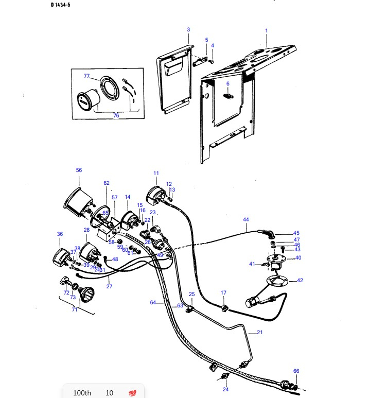

I had the exact same problem with the MF 30 industrial tractor.
Went through the Agco website which has most Massey Fergusson tractor parts info available (apb.agcocorp.com) to find a tachometer part number then bought and installed it about 4 years ago.
Ever since, the tachometer works as it should be.
