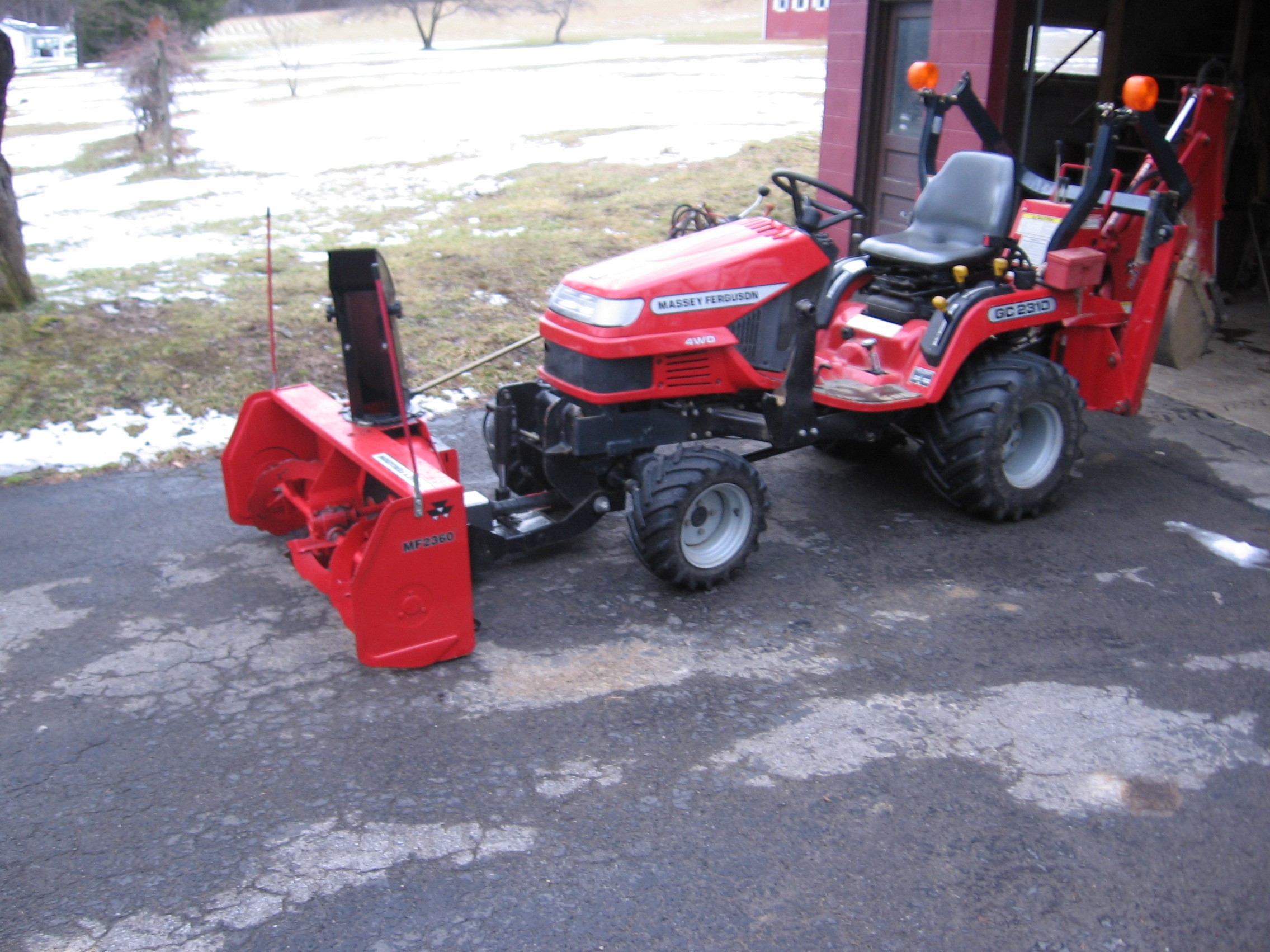

Will a MF 2360 snow blower fit newer 1700 series as well older GC models ?
   / MF 2360 Blower. #3
If you ment to say GC1700 then yes it will.
But if you meant to say 1700 seties or 1700e series then I dont know if it will work with any of them . . certainly notb) the 1700 e series.
( a point of reference. The GC1700 models are sub compact tractors but the 1700 or 1700e tractors are compacts. And the 1700e models don't have a middle pto as i recall. The 1700 and 1700e series have 2 or 3 different frame sizes and go from 23 hp to 59 hp. BOTH the GC1700 series as well as the 1700 and 1700e series are the newer lines if Massey since later 2013 or after)

It fits - GC1705, GC1710, GC1715, GC1720, GC2300, GC2310, GC2400, GC2600, GC2610 . Thinking about selling mine.
   / MF 2360 Blower. #7
Any reason why you would sell it? Is that a knock on performance or lack of need?
   / MF 2360 Blower.
It works great - only had it on one season. Primarily use my FEL to clean my drive. The blower part is same as a Kubota or Steiner, but attachment and lift mechanism are unique to those tractors. They are built in Canada. Will advertise locally to see if I get any interest.
