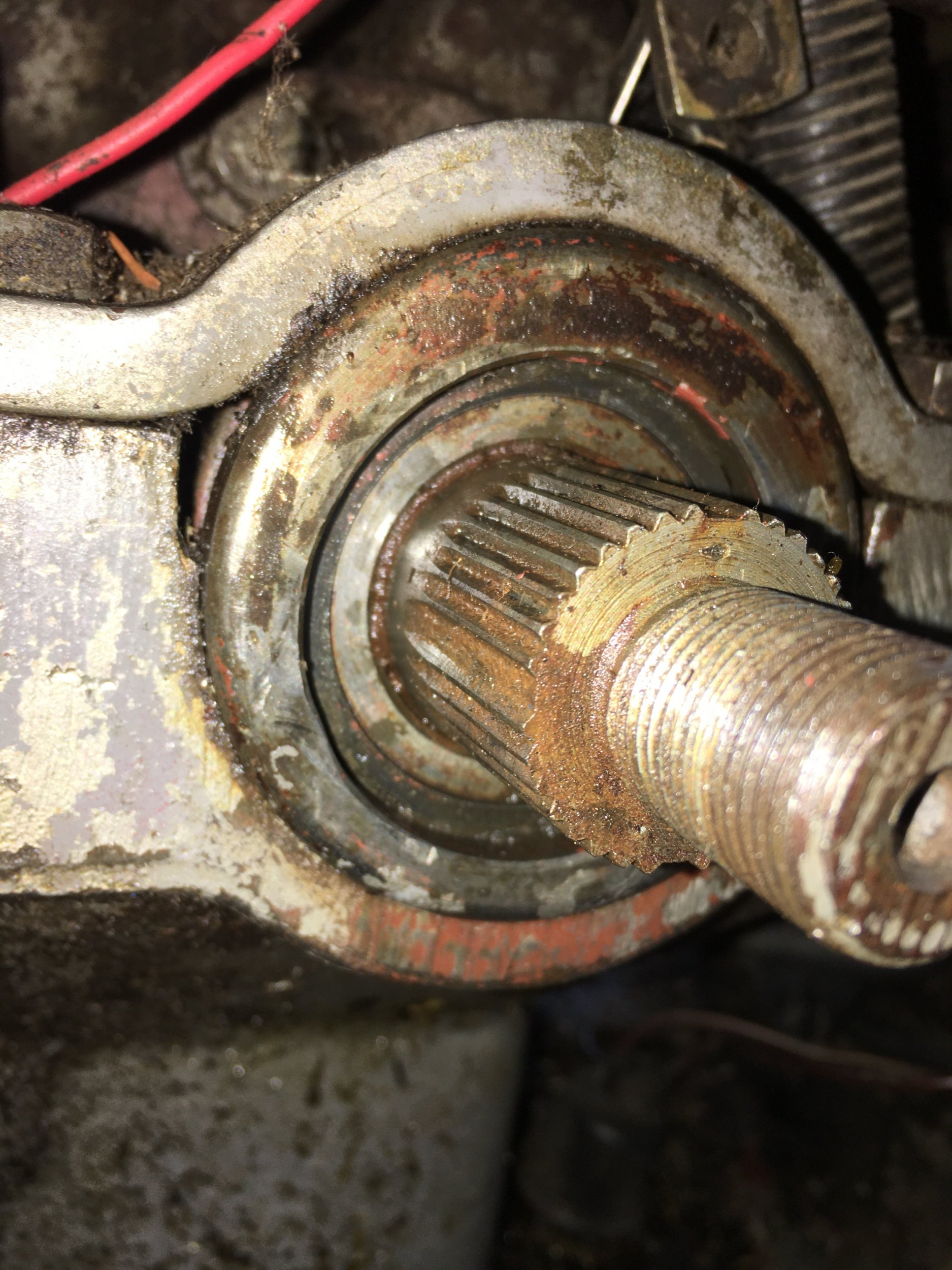

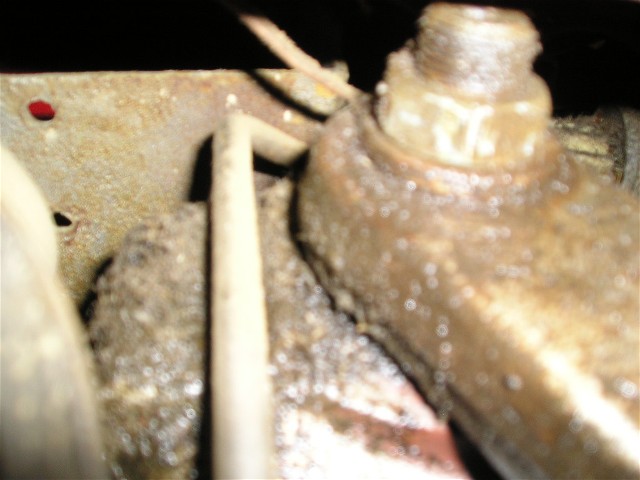

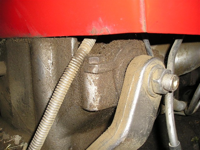

Here are some pics of pitman arm seal leak.
Right and left sides, left one is leaking.
So is there a fix or seal that can be replaced?

UPDATE from my dad and his Massey dealer.
Went to :thumbsup: today and went by the Massey place and got a seal for the steering on the Tractor. Cost was $14.00. The owner told me he was selling those tractors when they were made. He said the main problem was the shafts were too hard and would brake and mine had probably been fixed by factory. He also said the seals would wear out if the front wheels shook back and forth on the road, which mine does sometimes. Hope the seal will fix for a while. Thanks, Dad
   / MF 235 power steering leak
New seal in :thumbsup:. Better steering then it has ever been he says.
The old seal was hardened and sort of crystallized and had to be removed in pieces.
Guess nobody here has had to mess with the 235 before :confused:.

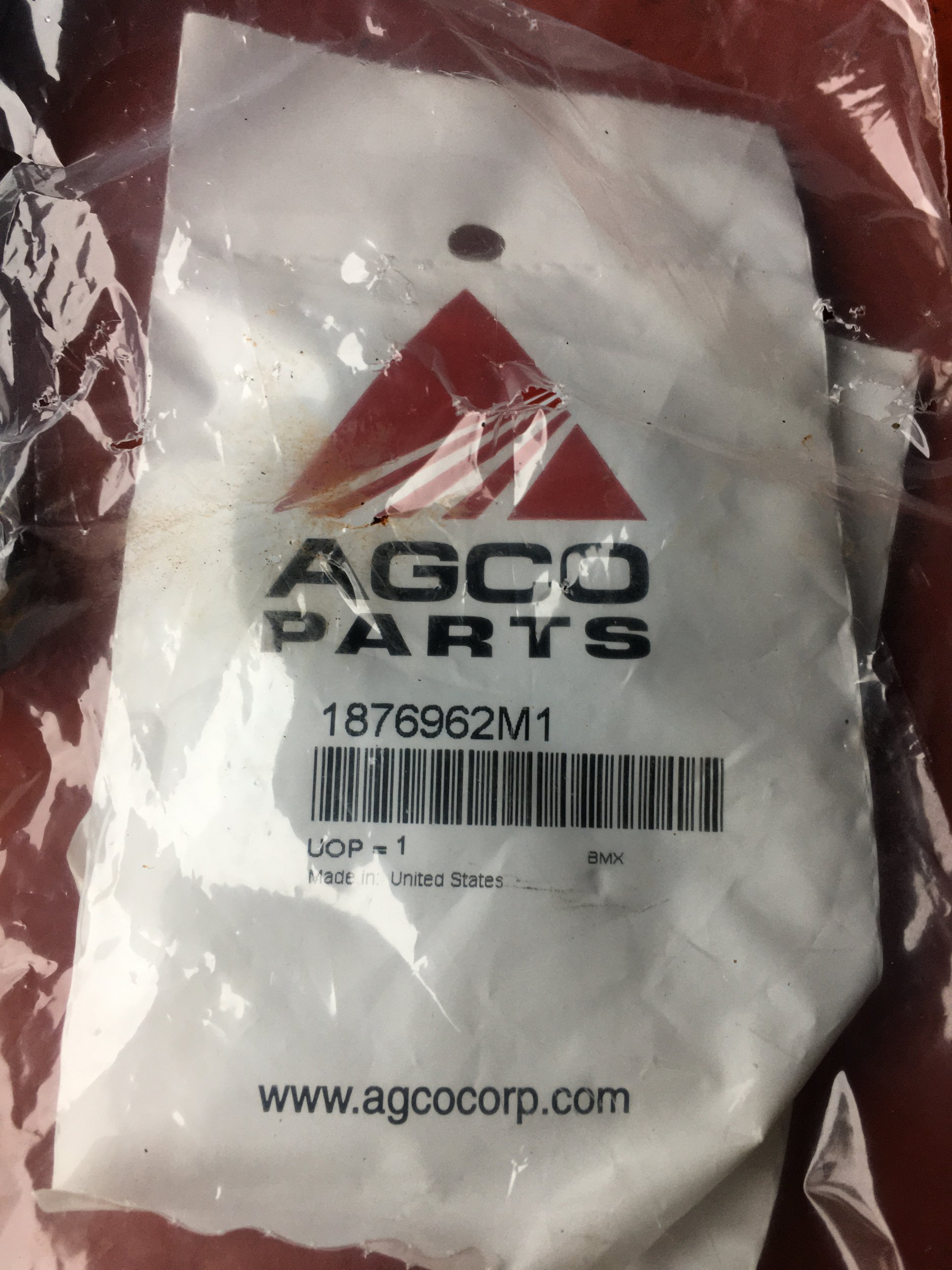

Any photos of seal placement? I have new seals. Pulled Pitman arm but not able to see part # AGCO 1876962M1
That was 12 years ago. No pics
I am 3.5hrs north of tractor. GL
