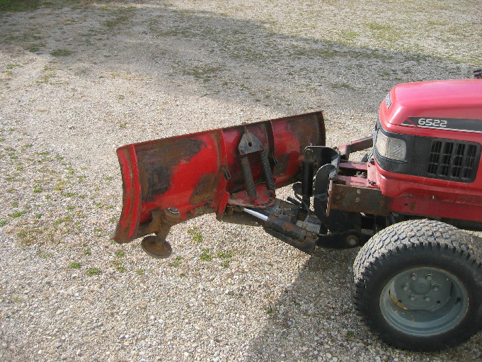

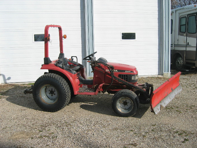

I have what I think is probably a MF 60" power angle blade on my Honda 6522. As long as the snow does not get too deep or too wet it is capable of doing a good job. When angled the effective length is less than 60" so with deep snow the swath gets narrower.
There are probably better tools for dirt / gravel work, but it can be quite effective for that as well.
One problem with this particular arrangement of front blade is the QA can ride up on the snow and leave you stuck. Say you're trying to move a bank of snow, especially previously plowed and can't push it with the blade on the ground - so raise the blade to take off the top of the bank - leaving 6" - 8" still on the ground. The QA will sometimes ride up on that and leave you stuck.
