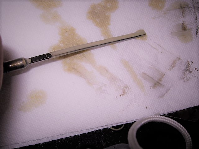

1- Does that oil look normal? That dipstick is from the position on the RH side of the tractor, under the seat IMG_0514.JPG

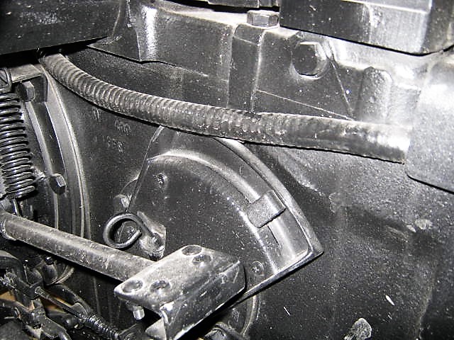

2- Under the seat, RH side, what is this adjustment? Same place, what does the pedal do?IMG_0510.JPG

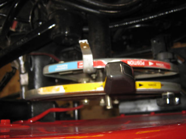

3- Where should these levers be set when running with a plow or disk?IMG_0512.JPG

If it was mine...I would start by changing all filters and fluids...who knows what schedule the previous owner was following...I did just that when I bought my MF 2605, manuals should be easy to get from any AGCO/MF dealer, the 231 was a popular model, so should not be a problem.
Picture #2 is the rate of descent adjustment lever I beleive for the 3pt...and your last picture is the position and draft control levers.
If it is like my 2605 (modern version of the 231)...the inner lever is for up and down, the outer lever is your draft control for ground ingaging implement, the more you put it down, the deeper your implement will penetrate the ground.
