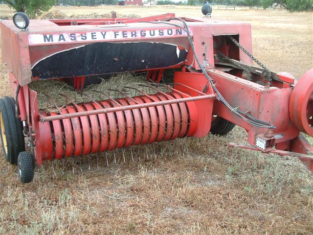

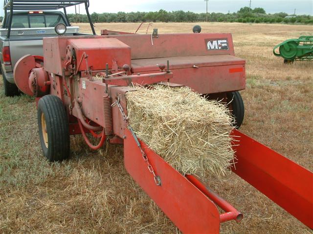

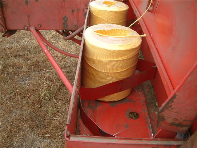

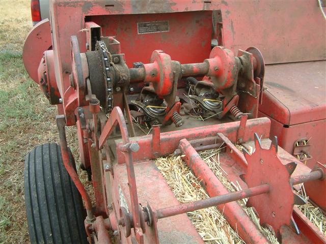

I bought an MF124 baler (two-twine, small squares) several years ago for $2000. It has the MF SureTie knotters--a very simple design that's easy to work on.
Don't know anything about your 224, but my guess is that the pickup, packer, plunger, knotter designs are similar to the 124. Here are a few photos of the 124 to help you.
MF124 baler hay bale.JPGMF124 baler knotters.JPGMF124 baler pickup.JPGMF124 baler twine.JPG
