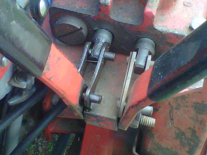

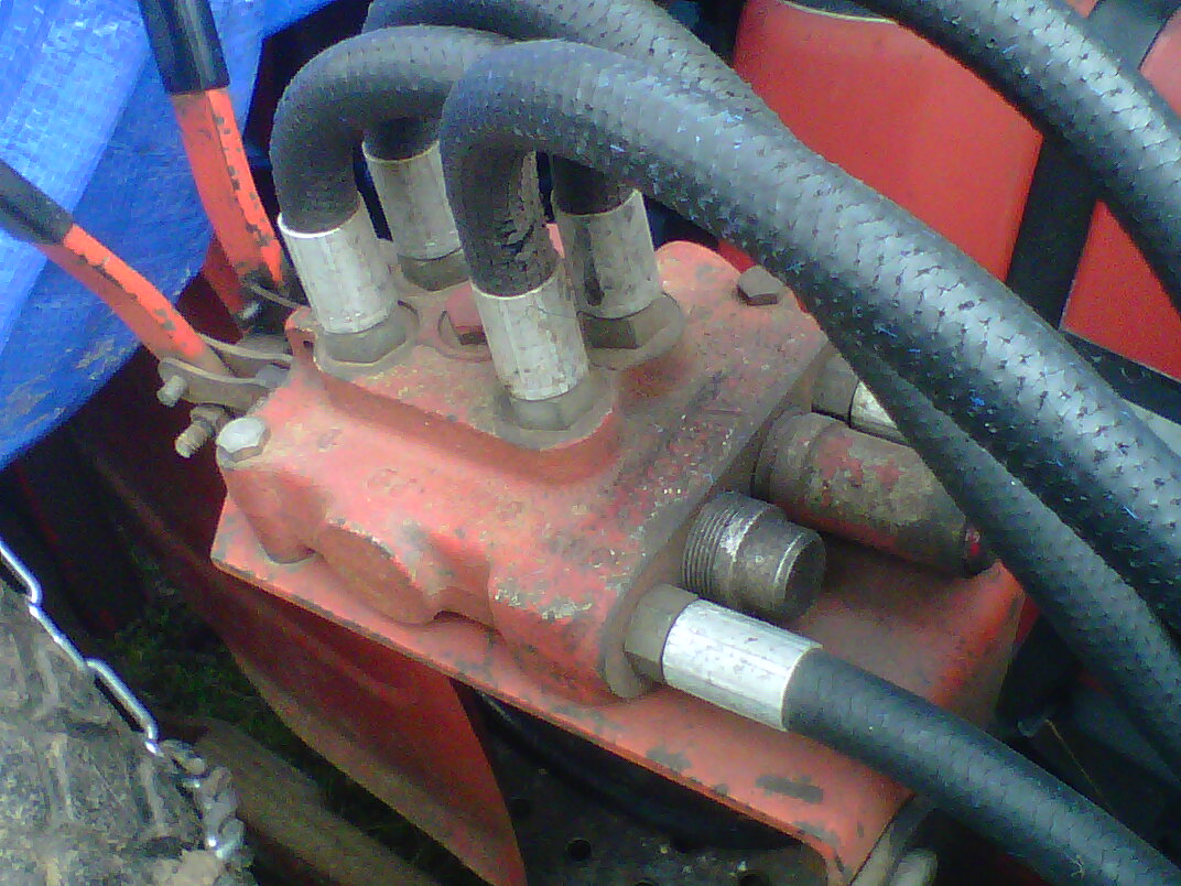

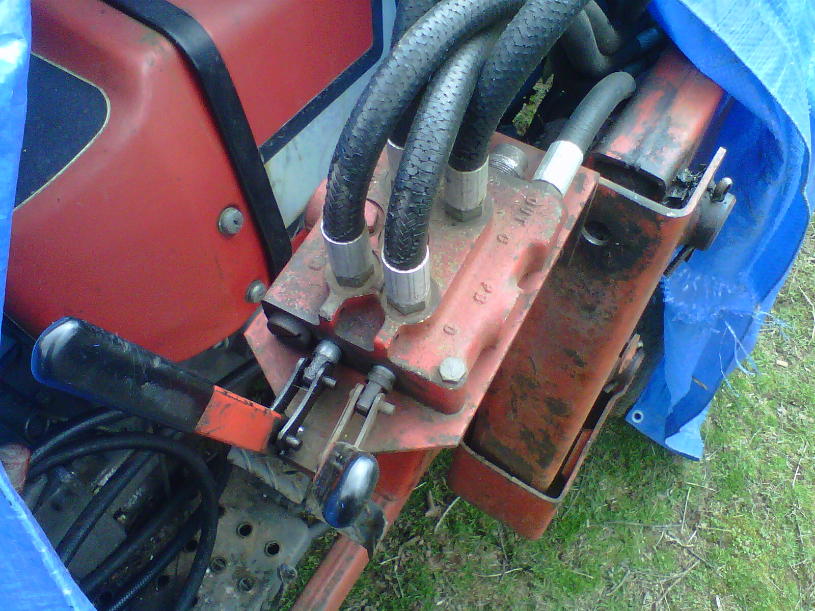

Can you take a picture of your valve especially the IN port?
This valve is for reference only. If you look by the IN port you will see the PRV. This is a joystrick valve, so don't know if yours will look like this. Most PRV's are close by the IN port.

Here are the pics of the loader valve
   / MF 205 Hyd question #6
In the first picture the slotted plug to the left of the spool is probably your relief valve. It looks like the in/pressure port comes into the to the bottom of the valve, left side in the picture.
You might take a good look at those hoses, they appear to be cracking. The bend looks a little extreme, You might come off the valve with 45's or 90 degree fittings
