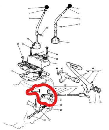

With all my respect to your 1000 posts (that mean knowledge) and also my 1st time on MF (used to use FIAT) as i said on B the pto engage very easy when there is nothing on 3points , when its free. So i ve already change the bold (on the red circle ) and the clutsh came too high , nothing has change, on monday i ll go to a service for check , but i want to beleive that i m doing something not in correct way.(sorry for my ENG) Inkedclu_LI.jpg

The bolt under your circel is a clampingbolt to adjust the freetravel for the pedal.
I am thinking that the pto going in easy will be with a slight grr. When there is laod on it wil make a much longer grrrrrrr and not goung in

First do the freetravel by loosening that bolt....lift the pedal and rotate that shaft going into the bellhousing until you have about 5 mm play at that clamping bracket s top to the casing

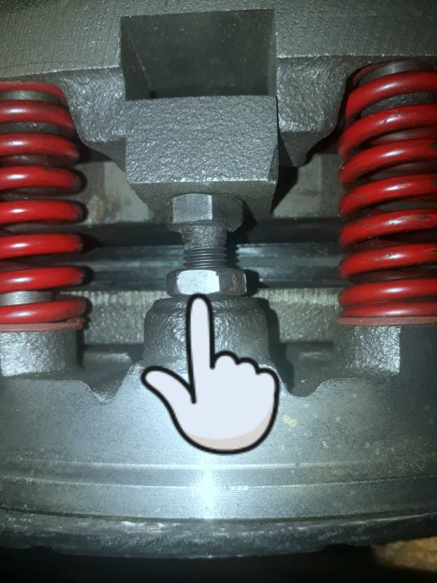

Look at bottom of bellhousing and you wil see that there is a inspectioncover . Open it with a 24mm wrench and you will be able to see the pressureplate.
Adj that bolt so that you have a clearance of 1 to 1.5 mm . All 3 must be the same !20180823_170333.jpeg
