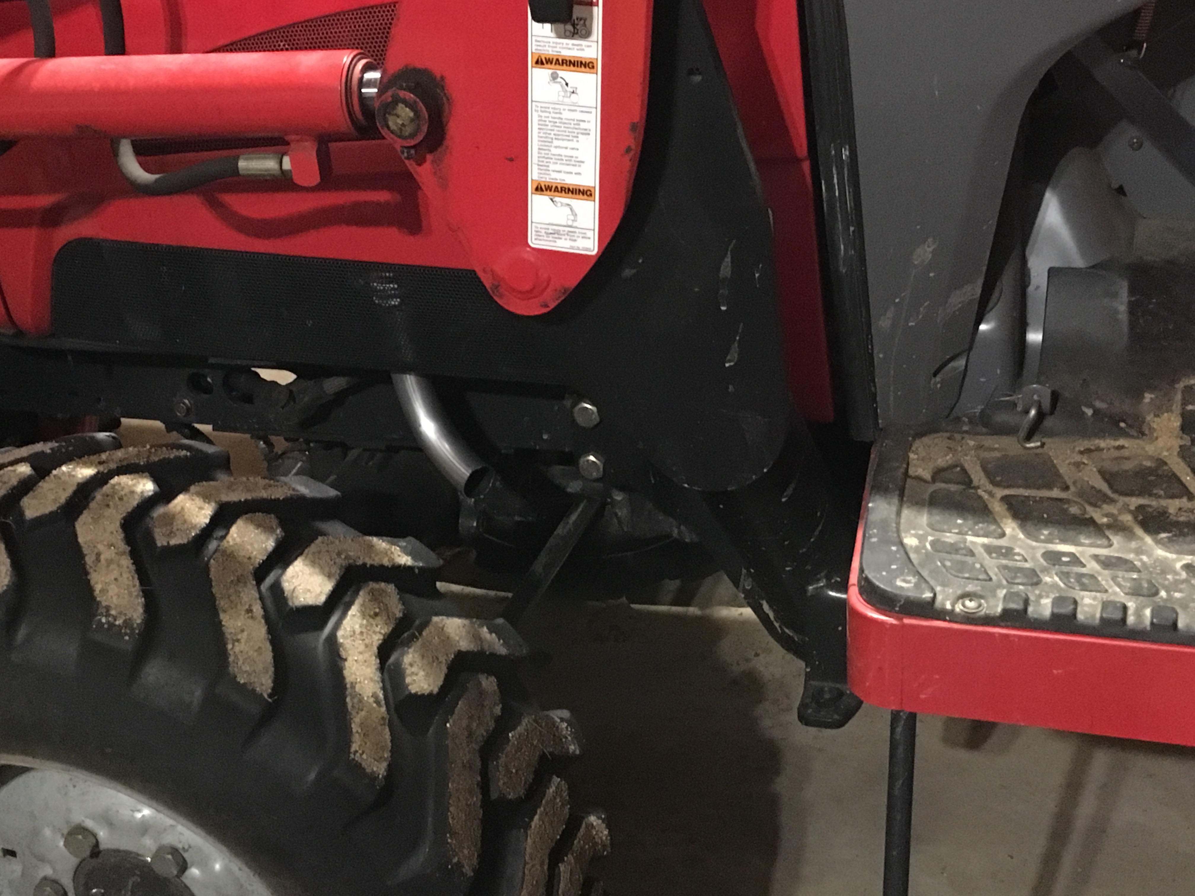

I got sick of seeing exhaust bouncing off my loader, going back to me as I drive forward.
Very obvious at night.
   / MF 1540 Exhaust Rerouted
#2
My outer air cleaner was half plugged with soot from the forward exhaust too.
This elbow was in stock at O-Riley’s for 6 bucks. It fits perfectly. The way I angled it is as outward
As possible , while missing the R4 tire in the most extreme axle tilt and left turn.
No more sucking soot. No more dirty air cleaner, and I think a tad more power.
My eyes and nose say it is a lot better than stock. 90 percent of the time, I am moving forward so the exhaust blows out and behind me , instead of in front of me waiting to drive through it. Visually, when cold or loaded, I can see it is almost entirely going under the platform.
I am a lot happier with it, as my lungs are too.
