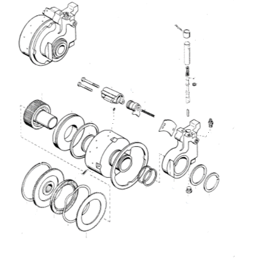

I have a 1967 MF 135 Diesel deluxe multi power with independent PTO. It has 6200 hours and runs great. I mow with this tractor with a 6ft finish mower. Yesterday when i went to disengage the PTO it started making a grinding (like gear teeth) sound until the mower stopped turning. It has been working great until yesterday. Normal i move the lever in the middle to let the pto slow down and then put it all the way down and it stops with no noise. Any ideas?
My best guess is the PTO brake disk broke and it making noise.

This IPTO utilizes multi-power pump pressure to hydraulically actuate the PTO clutch. It definitely has a PTO brake (which is integral to the IPTO clutch assembly).
I generally engage the IPTO smoothly, but always disengage it quickly and at low RPM (to reduce wear on the brake/clutches).
Typically the PTO brake wear plate (p/n 515475M1) wears out and no longer makes contact (and the PTO braking function ceases altogether).
While it's possible that it could be the PTO brake disk, the noise is more likely originating in the IPTO clutch assembly.
If that's the original IPTO, at 6200 hours, the IPTO clutch and valve could be showing signs of wearing out.
My idea is: get a service manual and start troubleshooting. I wouldn't use the PTO until I got to the bottom of it: what you don't want is to destroy "non-wearable" parts (e.g. hub, piston, clutch retainer plate. housing, etc.).
The wearable parts (clutch plates, friction disks, wave springs, piston rings, brake wear plate) are available. This IPTO clutch and valve assembly was designed to be rebuilt - I've done it.

I took the top cover off today and found a couple things. The PTO brake caliper is loose and flopping around. Also found the hydraulic line to the PTO brake is now broken from being loose. The grinding i was hearing was the brake caliper rubbing the center "drive shaft" to the pinon gear. The brake disk is just floating on the IPTO clutch housing. Next figure out why the caliper is loose.
Also the draft control does not work on her so i am going to figure that out while i have the top cover off and clean all the filters. It will randomly lift the 3 point all the way to the top like the pump is sticking on going to check that out as well.
Any advice while i have her apart?

The piston brake (caliper) should be attached with two 5/16" NC hex bolts.
There are variations on the IPTO Clutch and Valve assemblies with tractor S/N 46767 and up being the cut-off. Make sure you order parts accordingly. MF-135 IPTO Clutch & Valve.gif
With the hydraulic top cover on the bench, you should be able to troubleshoot the draft control by using the adjustment procedure in the service manual.

Update, It turns out the pin that comes through the side pto cover has a matching slot in the pto brake caliper assembly to keep it from rotating. That pin had backed out letting the brake caliper assemble rotate into the center pinion shaft. That was the rattling i was hearing. This also is what broke the Hydraulic lines.
The brake disk itself was the earlier style with no pins in the IPTO hub to keep it from falling off. I drilled the Hub for 1/8" split pins and the brake disk has a little play but not bad at all.
I thought i was going to get away without spiting her but i found needle bearing rollers in the bottom when i was cleaning her out. After some inspection This tractor has the early Flat bottomed IPTO/Multipower pump with the idler gear held by a thread in shaft. The needle bearing for the idler gear was gone and the shaft was stripped out of the housing and chewed up the ipto pump housing. Apparently this early pump is not available anywhere. I got lucky and found on ebay and entire Lift pump /ipto pump with the aux high capacity hydraulic pump out of a late model 165 for a good price and it is on the way. It is a 21 spline pump and my tractor is a 10 spline pump so i will either have to swap the assembly to the old pump or swap the shaft to the new pump. But that should get her up and going.
The IPTO was in good shape but i ordered new clutch disks for it since i have it apart.
This tractor did not come with the High capacity aux hydro pump. I plan to plumbing it to the side cover in case i ever need it since the new pump is coming with it. Any suggestions on how to do it?
The PTO side cover has 2 bosses the 2 bosses where the lines would go but they are not drilled. My plan is to drill and tap the PTO cover for the external lines and make up the internal lines to plumb it all up.
