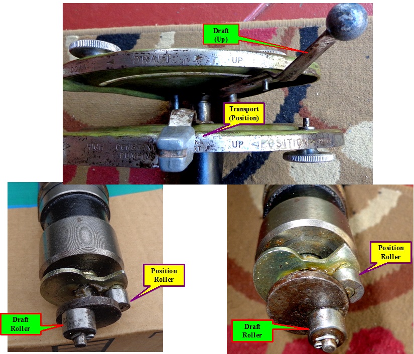

Greetings,
I am seeking some urgent help to figure out the correct way to re-assemble a rebuilt Quadrant for a 1968 MF-135 UK. The tractor was built with pressure control /dashpot etc. I have replaced both Draft and Position Control shafts /rollers and the support. My problem is that while the Position Control lever (inner) is "keyed" to the shaft and can be assembled in one way, the Draft Control lever(outer) is pinned through drilled hole to the the shaft and can be assembled in two positions .....180degrees apart. Only one way would be correct................... the attached images should convey my problem. It can either the config on the lower RIGHT or the one on the lower LEFT. Knowledgeable advice will be greatly appreciated.........see pics

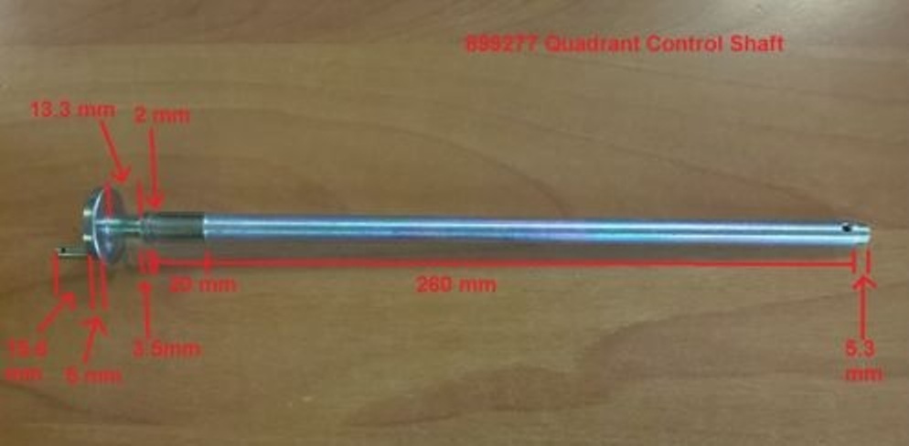

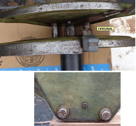

Hi Dave M7040,
Grateful for the prompt response. I have purchased hard and soft copies of the mentioned manuals. i even sourced the original UK Parts manual for this tractor. Unfortunately, none of them specifically focused on rebuilding/re-assembling of the Quadrant itself. Some MF-135 of that vintage came with pressure control served with a MK-II pump, some didn't. Others came with a MK-III pump and are different. Before attempting the rebuilding, I actually purchased a complete Quadrant Assembly and it was structurally different (internally and externally) from the original. That is the reason I decided to rebuild by referring to the Parts Manual to purchase original support, shafts, rollers etc. I should have taken a photo of the old one I took out from the cover but I didn't. I am still hoping that a member had an assembly in its original state to advise. See Pics attached...............

Thanks very much for your initiative on my behalf. If all fails I might have to consider bringing you to a warm place....LOL. On another forum a member suggested the Lower LEFT image of the first attachment is the most probable but I also saw someone in my same predicament went ahead with a hunch.......................that literally caused his MF-135 center housing to break in two inclusive of the top cover.................
