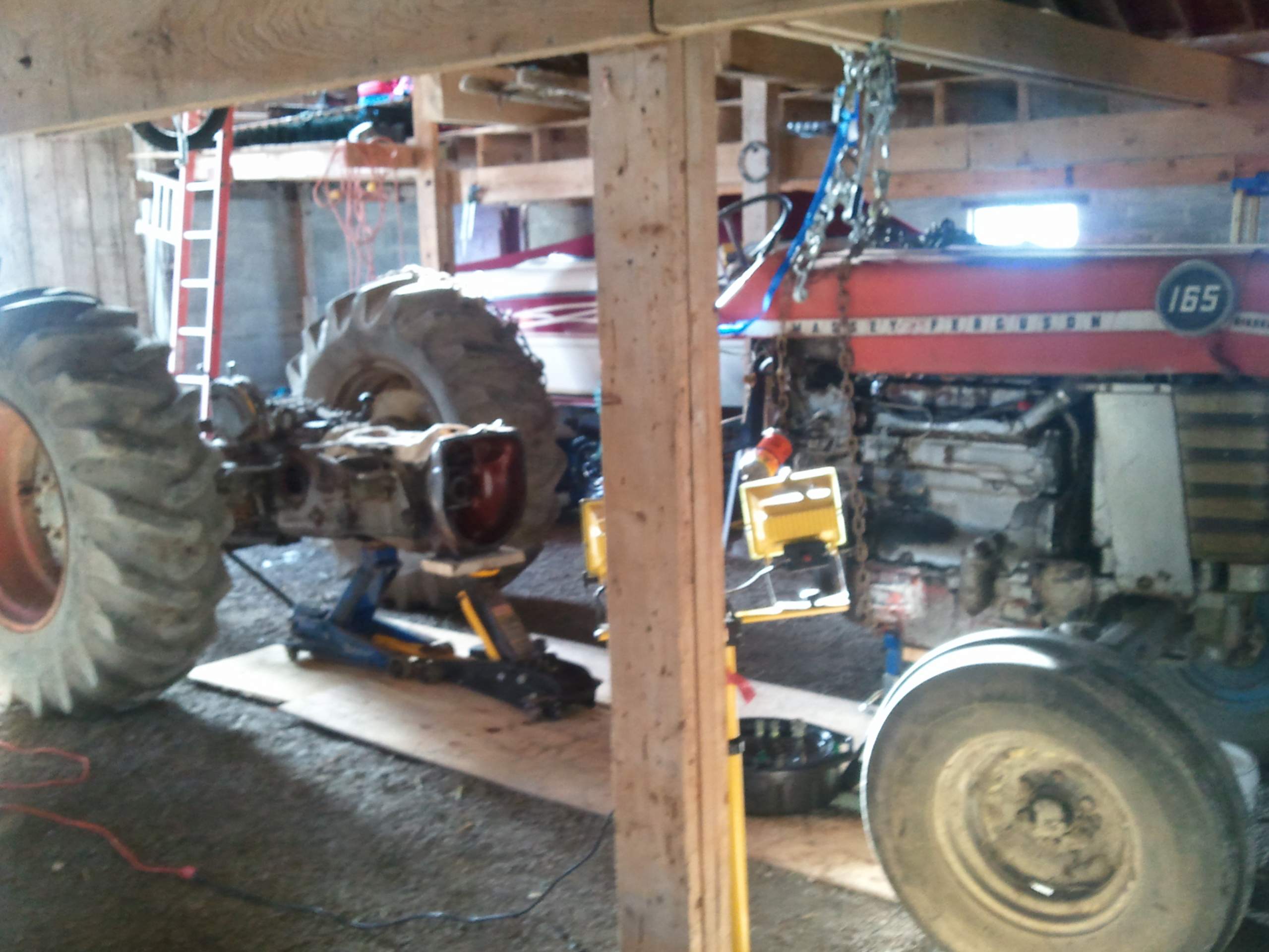

good batteries with high cold cranking amps and good cables will help, my 165 cranks really good after i changed to better cables and cleaned connections. good luck here is a pic of my 165 at the moment i have to rebuild transmission.
