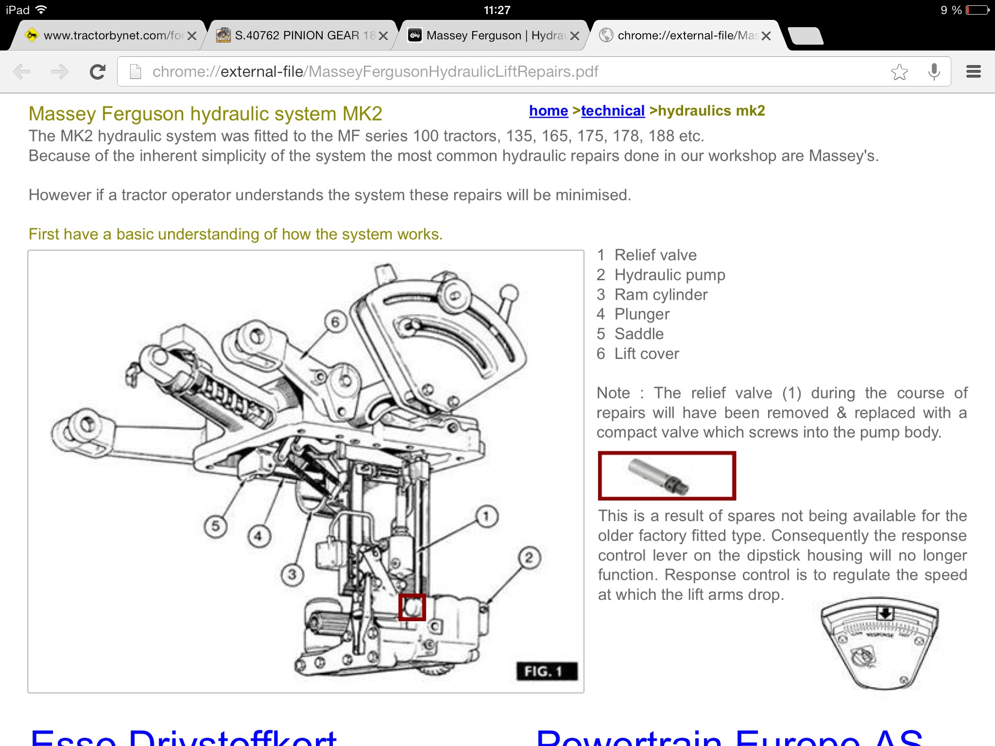

Hi,
I have read on a web site that the original hydraulic relief valve for a MF135 is no longer available and replaced with a compact screw in type.
I'm fault finding on mine and it still has the original valve (within the pressure control valve).
Has anyone done this conversion, is the old relief valve plugged?
Grayson.

G'day grayson.
I think that you are saying you want to fit a relief valve as in the parts list attached ?
If yes remove the pressure control unit and the link assembly that connects to the lift lever,the small pressure control pipe to the damper.
remove the plug on the hydraulic lift pump and install the relief valve.
You will have to remove the lift cover to access the pressure control unit and the new relief valve.
Regards
Hutch.
