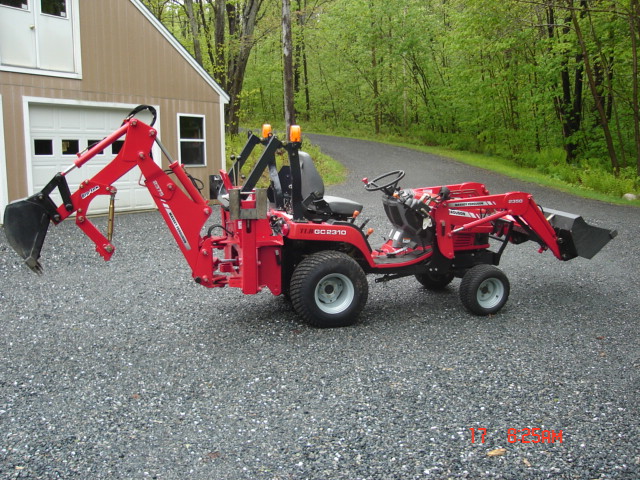

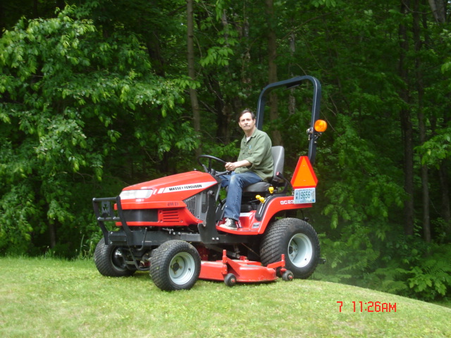

Oh-- just for comparison: the price you mentioned is less than 1/10th of what my MF cost... but I love it anyway!
Again, based on what I've read, $2000 for a working 135 sounds very reasonable. Wait to hear from Farmwithjunk.

And stop showing off that fancy little tractor to a poor person!!!! I could actually use the backhoe to dig trenches for water and power lines...maybe one of these days. Unfortunately, I can see a tractor turning into a toy, where every implement I see can be justified as a "need."
