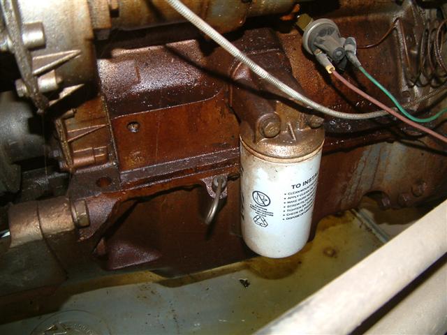

Oil pressure gauge? Got one on that 135? Is it working? If not, get a new gauge.
I have a 1964 MF-135 diesel deluxe with multipower. I wired a pressure switch and a big green LED idiot light (on the dashboard) so I get the green light ON when oil pressure is above 5 psi or so. That switch is the gizmo with the red and green wires in the photo. It's on a tee in the block. The other outlet of the tee goes to the oil pressure gauge.
