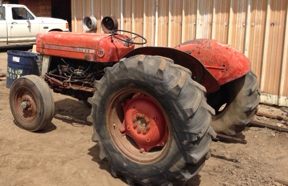

Hello Everyone:
I am starting to restore a 1965 MF 135 Deluxe (4 cylinder gas) that has been sitting in our tractor yard for roughly the last 7-10 yrs. I have been learning a great deal by reading the threads on this site. This project is a great learning experience for me and a lot of fun.

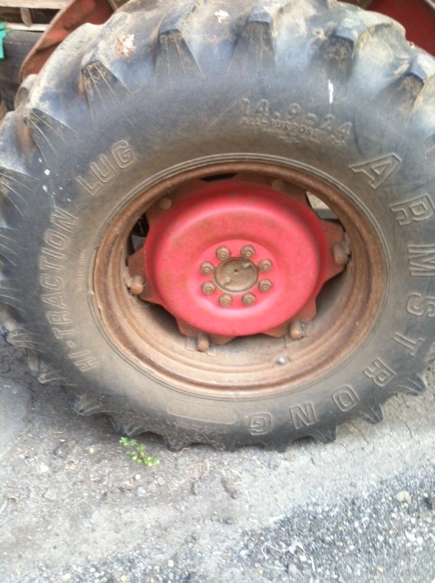

The tractor (as shown in the photo) may or may not have the original wheels. I would not be too worried about the wheels at this time because there is so many other issues to work on before painting, but an opportunity to purchase additional tires and wheels presented itself yesterday. I would really appreciate it, if someone could tell me if the wheels in the pictures are the original factory wheels. Since we are on the topic of wheels, is the original color scheme of the wheels in 1965 consistent with gray rims with red centers for the rear and the front?

Greetings and welcome to TractorByNet. I too have a 65 deluxe (four gauges). Your wheels look correct for the tractor. The outer rims where painted silver. The body of the tractor is painted Flint Grey Metallic. There should be a serial number plate in the engine block on the left side sitting on the tractor. If your tractor is a deluxe, it should be a Z145. I have a link to a thread I started some time back while I refurbished my tractor over the past year. There are many 135 owners here that can help with questions. Glad to have you aboard. -robert

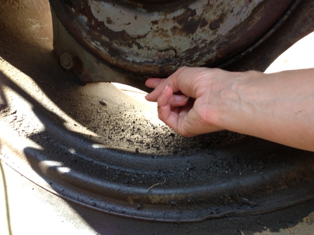

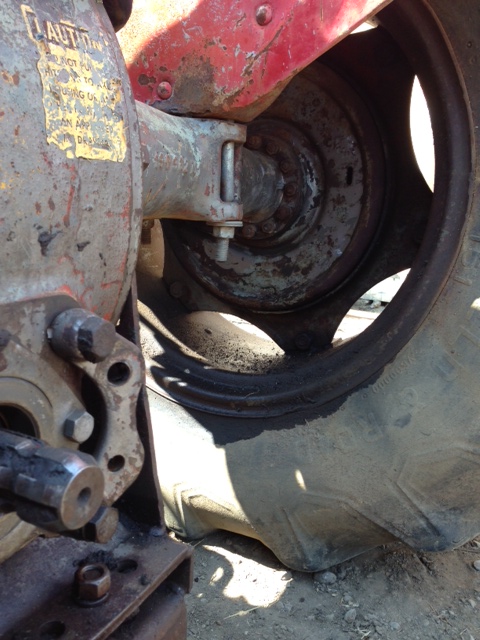

Question #1-What is your opinion of the leak in the attached photo? That is my next project.

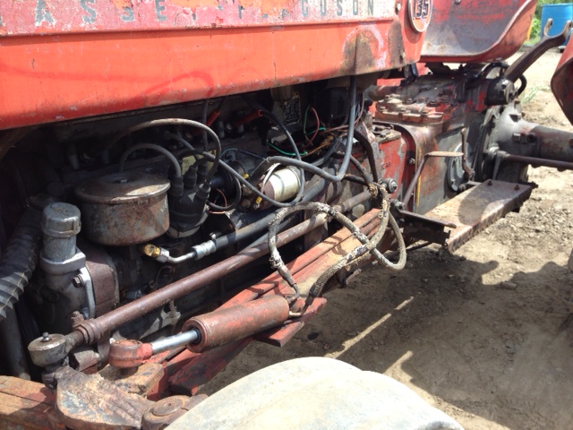

Question #2-In the 2nd photo, it appears that over the years a piece may have broken a new piece was fabricated. It is the piece that the power steering cylinder is attached to, do you know what that piece is called? I would like to replace it. We might have one sitting around, but I doubt it. I work for two farms, and back in the day, this was the tractor that was used in the orchards and I have access to some parts. I have found an additional hood and the metal side section that goes around grill (with lights) that were sitting in a barn.

Re the outer axle oil leak. Fix it. The seal has failed. Also the oil will have wrecked your brake lining. Replace or reline, BUT BEFORE refitting the brake shoe clean the oil out of the brake drum first.

If you don't have the service manual, they are still available at www.agcopubs.com. I highly advise you to get some form of service manual. One can do more harm than good loosening the wrong bolts at the wrong time. Jensales and AGCO are the top two best references out there. Both are excellent and both have their shortcomings.
I noticed your PS ram is attached differently than factory. It could have been a later add on or replacement at one time.
The serial number tag on the engine block doesn't look quite right. I've never seen one like that. Two rivets are missing, so it is suspect.
The wheel has definitely as mentioned a seal failure. This could be as simple as pulling the axle and replacing a few dollar seal. -kid

The steering cylinder is most likely a conversion added by a previous owner. Massey 35's and 135's with power steering use a steering cylinder built into the steering column. The cylinder rod is pinned to a rack that drives a gear that gives power assist steering at best. early models cylinders were connected to the rack by a 3/8 diameter pin. This size proved to fail prematurely and was later upsized to a 7/16 pin. (I believe these sizes are correct) When the front wheels were in ruts and the steering wheel was turned by Jack Armstrong the pin would shear. Some dealers disabled the cylinder in the steering box and added cylinders to the tie rods to give the steering more power and a stronger overall system.
