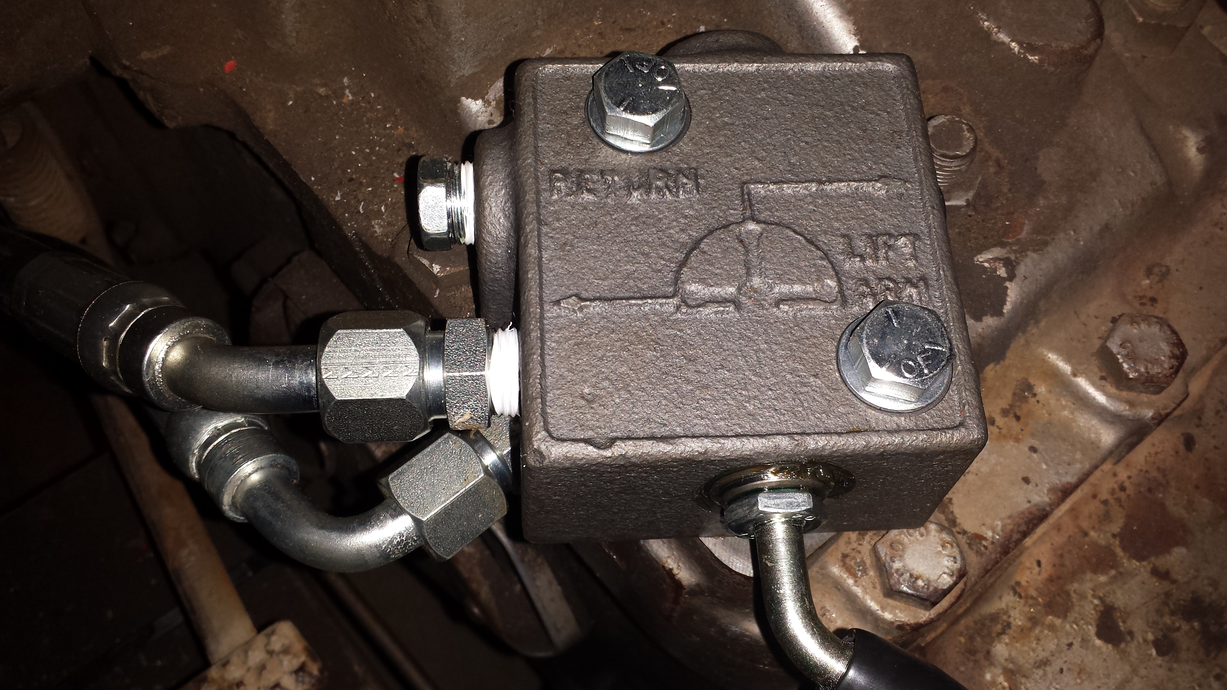

I have a similar question posted in MF category but since this is a hydraulic issue might have better luck here. I have a MF 135 that I just finished installing a MF 200 series loader on to. I have installed a divertor valve on the lift cover and suppling a single stick 2 spool loader control valve with float from it. With the 3pt lever in constant pumping and the divertor valve lever 180 from lift arm position on valve the loader only works when the lift arms are raising. As soon as the lift arms get to the top of travel loader stops operating.
There was no instructions that came with the divertor valve but I think I have figured out the flow schematic correct me if I am wrong. The right side of valve in pic is lift arm only, the center is remote/ aux only, and the far left is lift arm and remote. Is this correct? If so I believe I have my loader control plumbed in to the lift arm and remote port which could be my issue. I am going to relocate my loader control to the center port and try it again.

The trick is to lift the arm almost to the top then change over and then lift the lever to the top. That way the pump will keep on pumping and supply the controlvalve with oil
