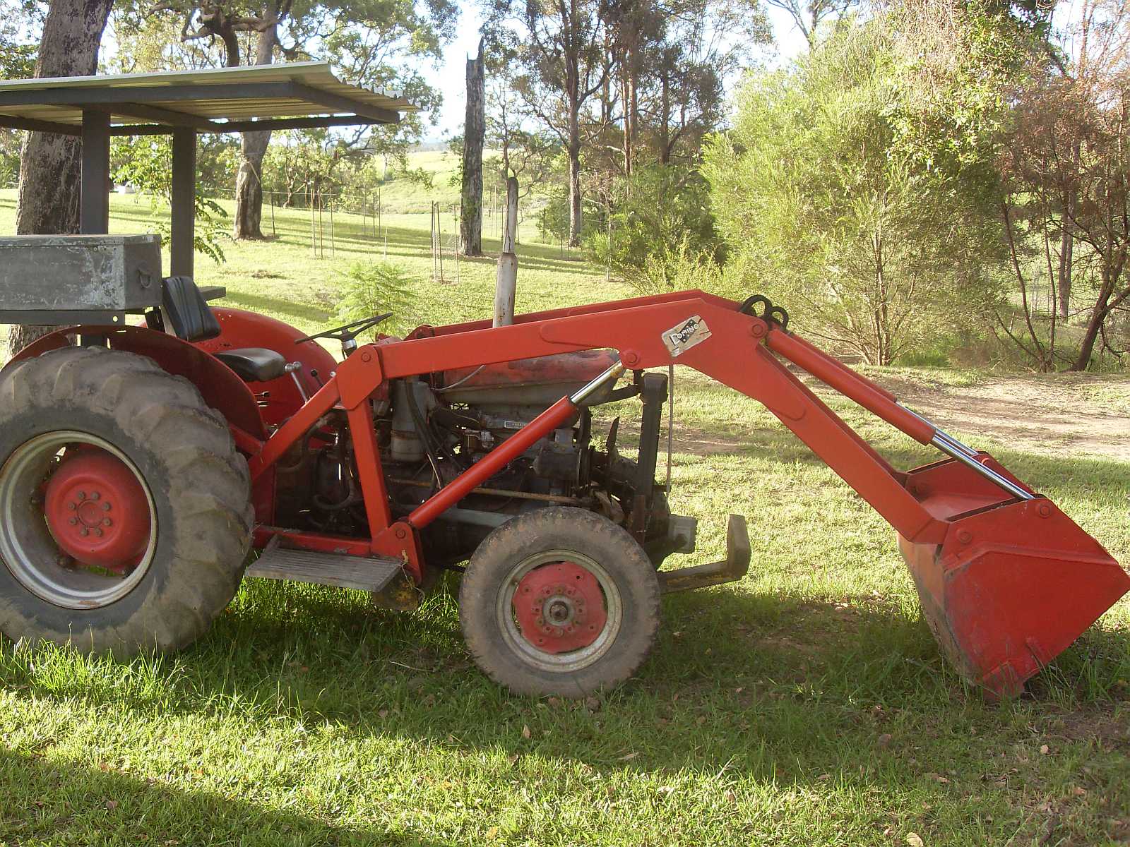

I just got a MF 135, Diesel, and I am having some trouble with it.
The FEL wouldn't pull the skin of a rice pudding, and I was wondering if this is normal or is there something I could do to increase it's lifting power.
The FEL controls are leaking, so I imagine that this may have something to do with its poor lifting performance, does anyone know how to fix the leaks from the controls?
I haven't come to grips with the Draft Control and the Raise Lower controls, can someone explain it to me in simple language?
The generator has Sh*t itself, I can get another genny but I thought I would try to fit an alternator instead, can anyone tell me how the Delco SI/10 single wire alternator goes a low speed, I thought I read that they don't work as well as other at low speed, and can anyone tell me where I can source one in Oz?

Welcome Michael - I am sure other will chime in but off the top -- which FEL and controls do you have -- is it a front pump model or run by a diverter under the seat -- pics would help

The hydro pump is one that is out front of the engine.
The tacho drive is not a problem it is mech. driven and doesn't work anyway.
I am also now having problems with the 3pt linkage, it doesn't want to lift much at all, any suggestion as to this issue?
I have attached some pictures of the beast to this message, hope they help!

Definately not a factory type FEL:D:D
With your latest post about the three point I am wondering if the FEL and tree point are using the same reservoir for fluid? If so is there actually fluid in there?

Yes, both the 3pt linkage and the FEL use the same reservoir for fluid, but I have filled it up, it was low, but the 3pt is still not working properly, the FEL works OK until you fill it up with dirt then it won't lift it.

G'day Michael first thing, for your alternator find your nearest Bare co distributor they make one esp to replace the genny, also you may want to check them out for an owners manual, as for your linkage not working that may be something to do with your lever position, as for your loader problem i think you may want to check your relief valve setting or get someone to check for you should be approx 2-2500 psi. Hope this helps
By the way love the roof on the rops
