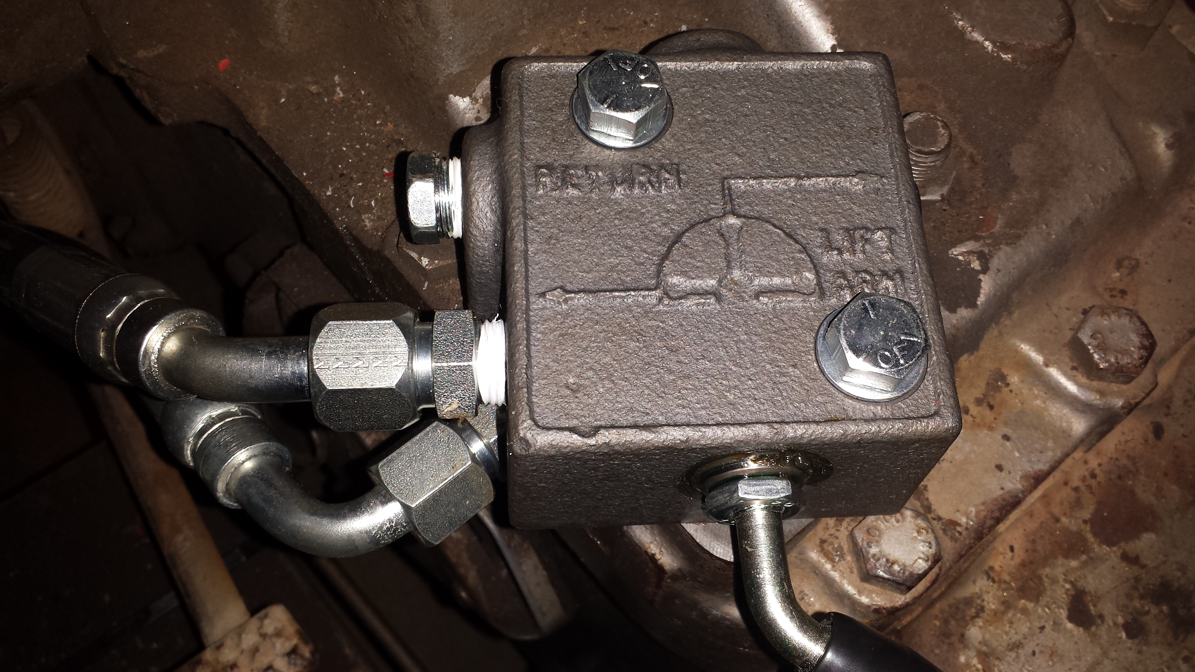

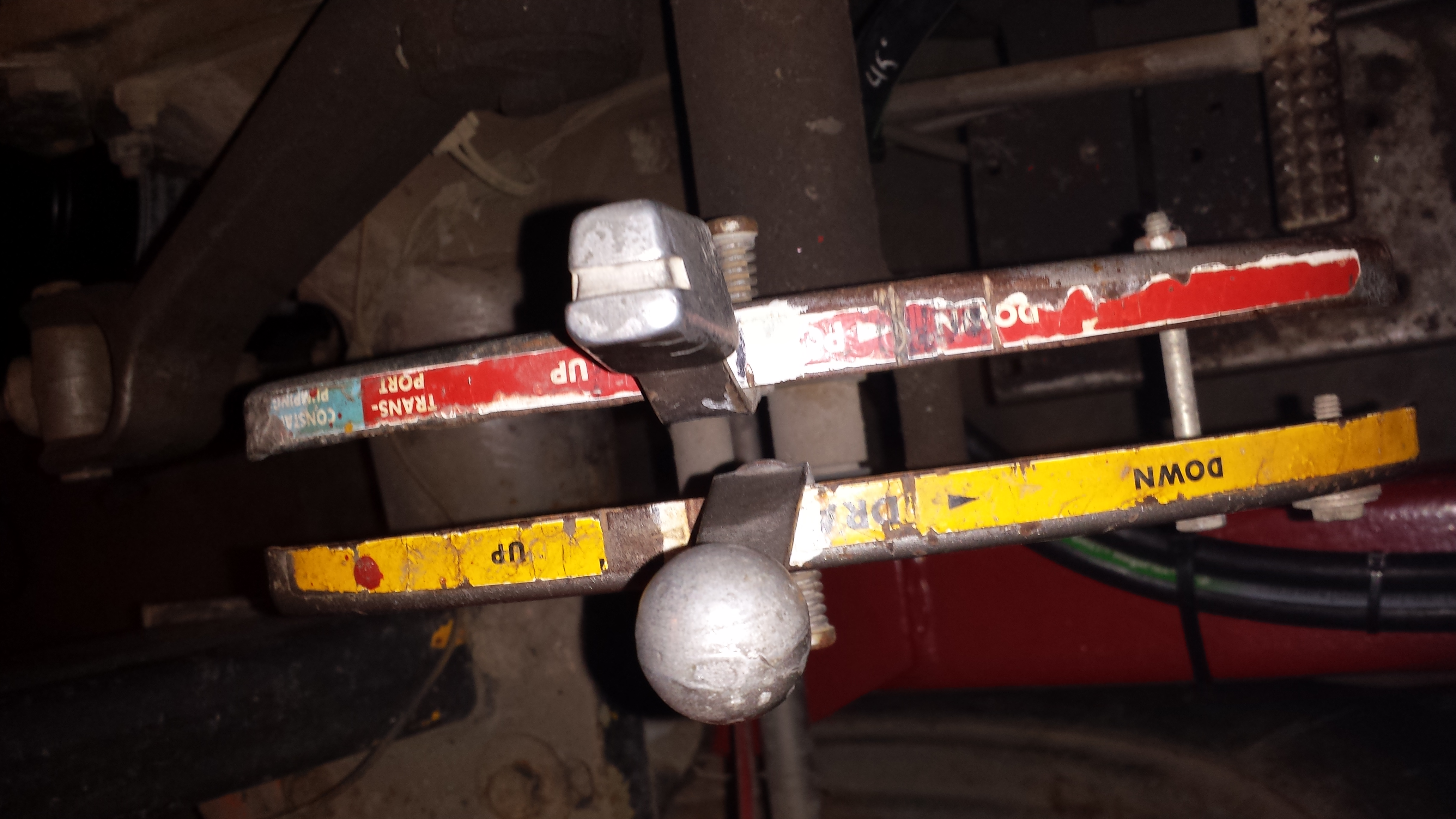

I have just finished a MF 200 series loader install onto my MF 135 tractor. I am using the tractors internal oil resovoir, and pump rather then using the loader frame resovoir and external pump. I am aware this may cause slower loader speed and reduced capacity but it is just being used to clear a few small town driveways of snow. I have installed a divertor valve on to the cover plate, and am using a single stick dual spool loader control valve with float. My loader valve is supplied by the divertor valve and the return is plumbed into the trans housing under the divertor valve. When the divertor lever is positioned opposite the lift arm setting, and the square handle lever is in constant pumping position the loader arms will go up but not down and no bucket functions operate. If I mover the round handle lever into the lower position then when whieght box is down move the lever into lift position the loader and bucket will work fine until the 3pt hitch reaches the top of lift travel then loader functions stop working. I am going to attempt to post pics. Any suggestions as to what is the problem?

As I see you have badly connected the return of the command, it must be connected to the gray box where it says "return"
   / MF 135 FEL hydraulic issue.
Thanks for the reply. You are correct I discovered this a few days ago and it is corrected.
