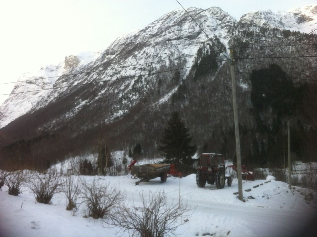

Thanks for all the feedback!
I just had a test drive and the lock seems to engage now :thumbsup:
However, the pedal will not stay down for more than a few seconds, but I assume that is because I had good traction and no spinning. With some force/load I assume the differential will stay locked and the pedal will stay down. Will try tomorrow when I go in the woods with it.
Here is what it looks like today:
