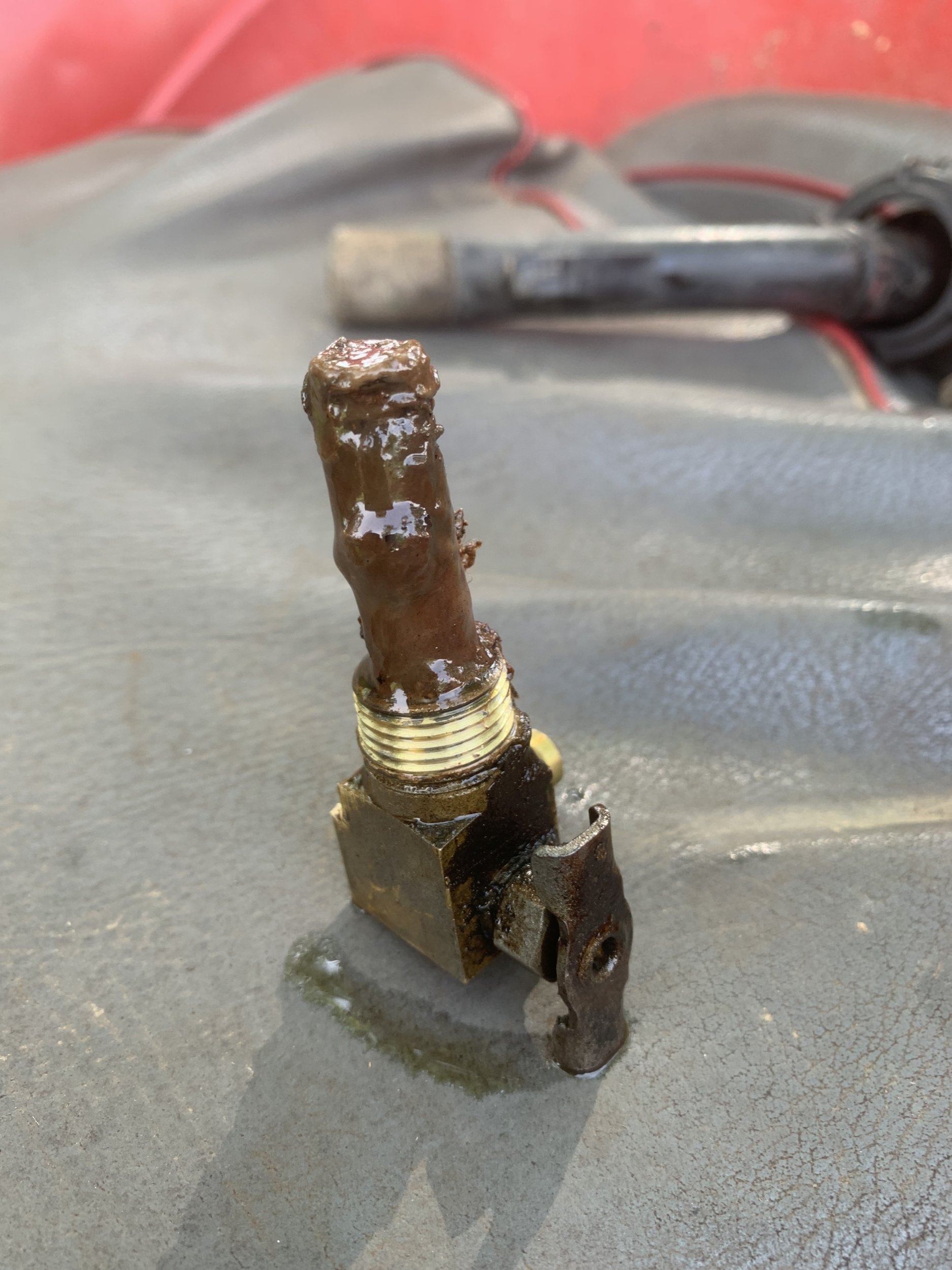

MF 135 diesel not starting
   / MF 135 diesel not starting #1
LandmanCPL
May 20, 2023
1
Massey Ferguson 135
The problem was this clogged in tank fuel screen… drain fuel into a funnel via a hose… connected to 5 gal. Container(s). Remove fuel line and shutoff valve from bottom of tank. Clean with gasoline or solvent… reinstall add clean diesel and bleed out air…
