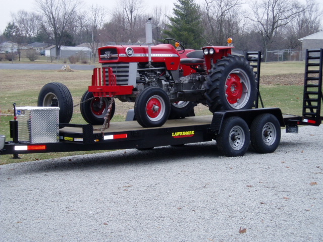

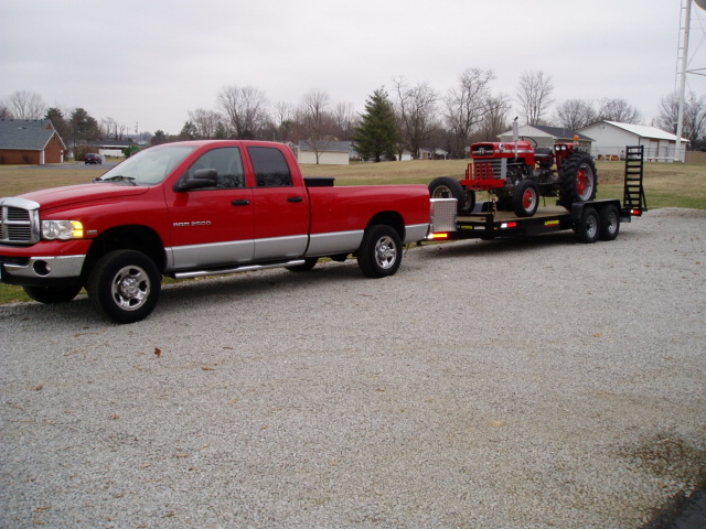

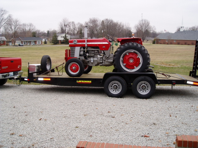

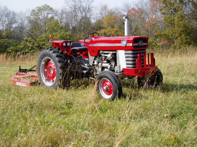

Here's a few pictures of what happens when you have a 100 series and too much time on your hands! This one has been with me since new in 1971.

FWJ if you'd clean that tractor up a little it might look a little better.:D Really, I remember those when they were new I don't remember them looking that sharp then. LC there is something for you to shoot for when you decide the 135 "needs" cleaned up a little.;) Hope the tractor works out good for you.
   / MF-135 at local trator lot #7
Holy Hawkeye FWJ...that is beautiful. Now if I can get my 165 remotely close to what you have, I will be a happy man!!!
