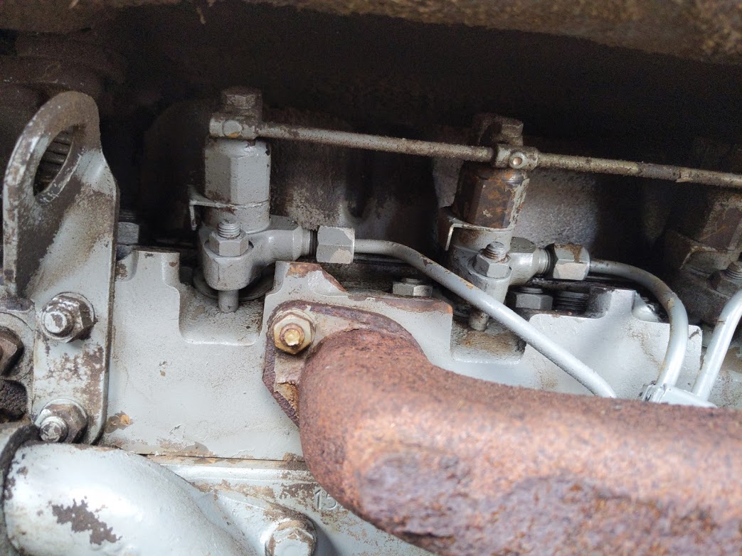

Hi Folks.
We've just completed what, to us at least, was a fairly major job - fitting a new shear coupler. That actually went surprisingly well once we'd found that was the problem (lost all drive following a lock-up with a mulcher).
While the old girl was in the shed we did some other routine maintenance including changing the fuel filters.
Last time we did this - it all went well. Just bled the injector pump while cranking over and she was good to go. This time though she doesn't want to know.
I've got diesel pumping happily though both bleed points on the pump without spluttering, so I'm guessing that I've got an air lock in the pipes to the injectors themselves? Does that sound reasonable?
I think that means loosening the nuts on the side of the injectors and cranking it over again (no manual lever on the lift pump on this model). I'm not sure though from what I've read and thought I'd check in for some advice here first.
If I do, do I do all three at the same time, just one or each one in sequence?
Many thanks

UPDATE - She lives!
Had another go at cranking her over and this time, she started. All looks good.
I'd still be grateful though if anyone could help out with the right process for priming one of these - the manual I've got and everything I could find online all refer to versions with a manual lever on the lift pump

Once u get fuel to the bleed screw by the name plate on the pump.. it should squirt out w/ force.
Loosen ALL THE LINES AT THE INJECTORS {or as many as u can reach} & spin the engine, until fuel squirts out there & tighten..
Once the engine is running, loosen the bleed screw on the top cover of the inj. pump {if so equipped} until fuel comes out of IT & tighten.
When bleeding or just STARTING the engine, the throttle should be AT LEAST, 1/2 way to FULL THROTTLE..<< VERY IMPORTANT.
Good luck & I'm glad u gott'r started.

Hi Perry, I've got a twin sister to yours - Dad bought it when I was 7 or 8 years old. Aside from being so useful and reliable, I'd never sell it because it's been "ours" since new.
As far as bleeding the fuel system goes, the lift pump should have a handle for manual priming and bleeding, but a lot of replacement lift pumps don't have this useful feature. It also relieves the poor starter motor of a lot of hard work. Remember to crank in 10sec bursts with 10sec pauses.
I have found this primer helps a lot when removing the air after changing filters because the fuel can be pumped into the filters, and the air released through the bleed screw on top of the second filter, without needing to crank the engine over. This prevents the transfer pump (inside the injector pump) from sucking the air along into the injector pump, causing the trouble you had.
That said, the next step to take in the situation you had was exactly what you did - open the lower bleeder on the pump and crank the engine until fuel appeared, GENTLY close it and repeat this with the upper bleeder. Then loosen the injector pipes, move to full throttle and crank over - this is the only way to clear air from here. When you see fuel, tighten pipes and crank another few seconds and it should start. After it starts, as ThePumpGuy stated, open them a bit again and release any further air. Remember, they're delicate.
Nevertheless, you got there. Any pics for us?
