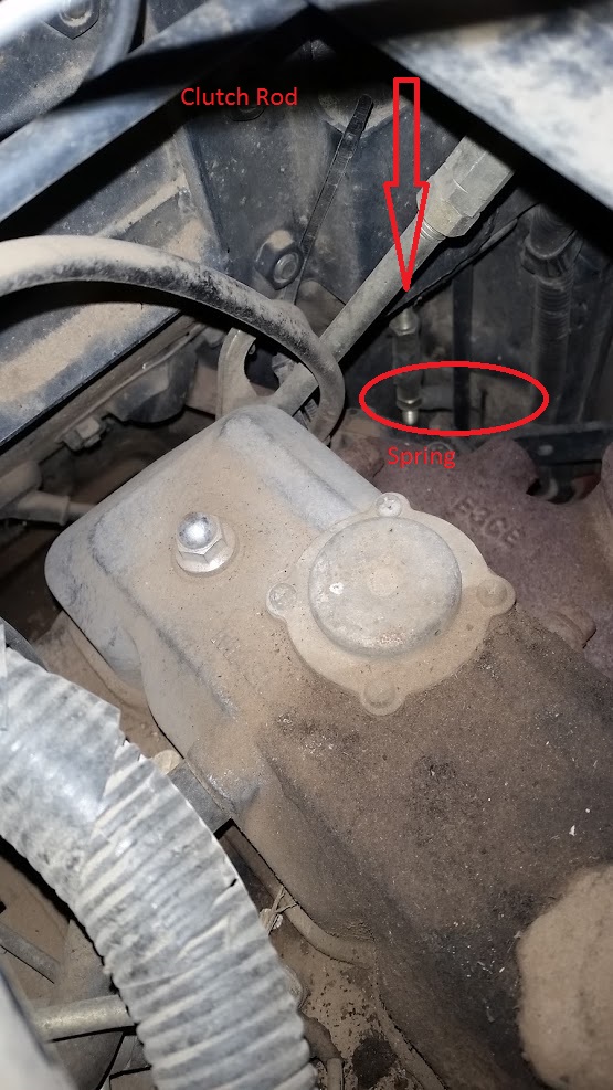

Okay, I was able to get out and tinker a little bit more today! I don't know if this is the problem, but I found a spring on the clutch rod that attaches to... nothing. I may not be a clever man, but I'm pretty sure that a spring should be attached to something at both ends, otherwise why even have it there? Could this be the culprit?

I would seriously doubt that the spring or anything related to it is the cause of your current problem. If it's involved at all, it may be no more than return spring intended to pull/hold the pedal up while not in use. The adjustment of the clutch rod in the picture would be of more concern. This adjustment is one of vary few items accessed from the outside that can have much affect on the internal function of the clutch.
