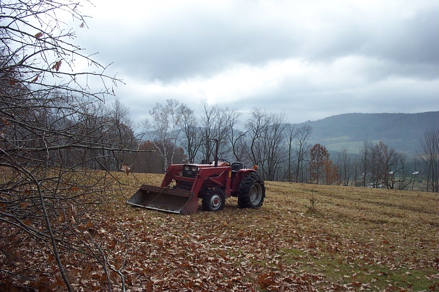

Good Afternoon Matt,
If the tractor is in good shape and you can get it for a reasonable price, then it might work out for you. I own the MF 1040 and I have had very good luck with it so far. I bought it with 1300 hours on it and now have over 1500. No major repairs so far. The problem with this series of tractors from Massey is there were so few of them that parts can be a real problem ! Alot of your bearings and seals can be cross referenced if you take the time to da it that way. Its also cheaper than going to Massey Ferguson, Napa will be able to supply alot of parts this way ! I paid $6000 for mine a few years back and so far so good. If you have some mechanical ability, I think you should be OK. But remember that any castings or such will be almost impossible to obtain !
If you dont know alot about tractors, you might think about bringing a more knowledgeable person with you to look at it !
TractorData.com Massey Ferguson 1030 tractor information
Here is a link on the MF 1030 !
And here is a pic of my MF 1040.
Good Luck ! ;)
