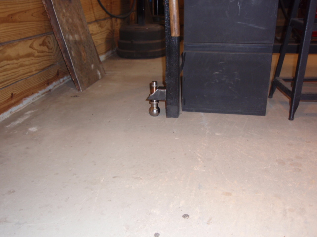

I needed this to work on patch jobs on mower decks. 1 7/8" ball. Metal shaper.JPG
   / Metal shaper #2
How does it hold up? I'm not sure how hard a hitch ball is. I think that most metal working forms are hardened.
And most hitch balls I've seen have a flat on the top. Was it hard to find one without a flat?
   / Metal shaper #3
A lot of blacksmiths rig them up in the hardy holes of their anvils for the same reason. A grinder with a flap wheel takes care of the line around the flat spot. I don't have one set up yet but they say it works well.
   / Metal shaper
This ball is old.... it was round from the start. It works great on thin metal, and with some heat it will work on 1/8" nice..

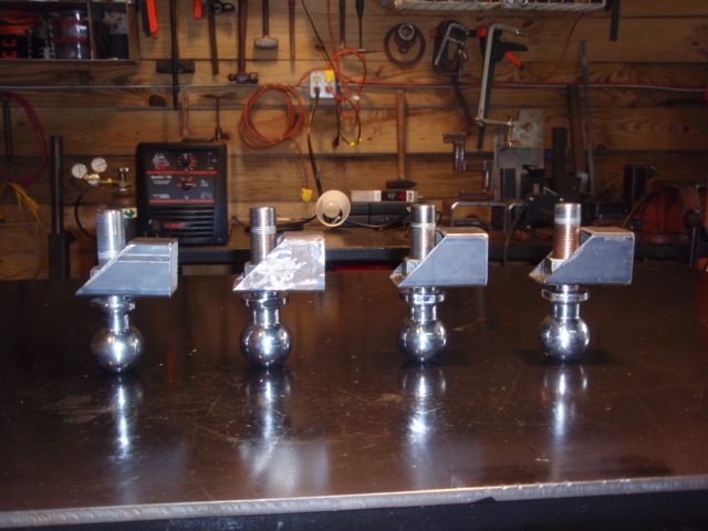

Leveling feet.JPGHere are some flat balls, that I welded on my table for leveling.Mock up.JPG
