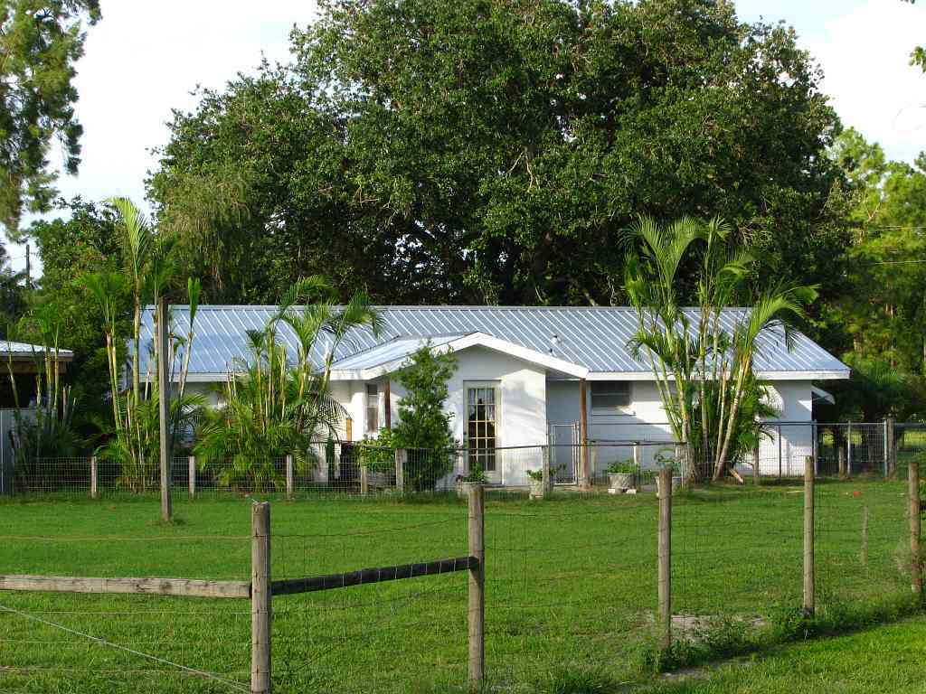

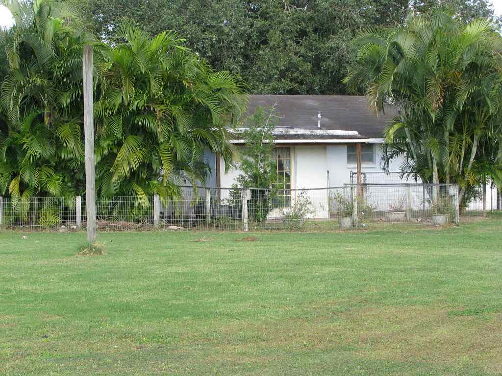

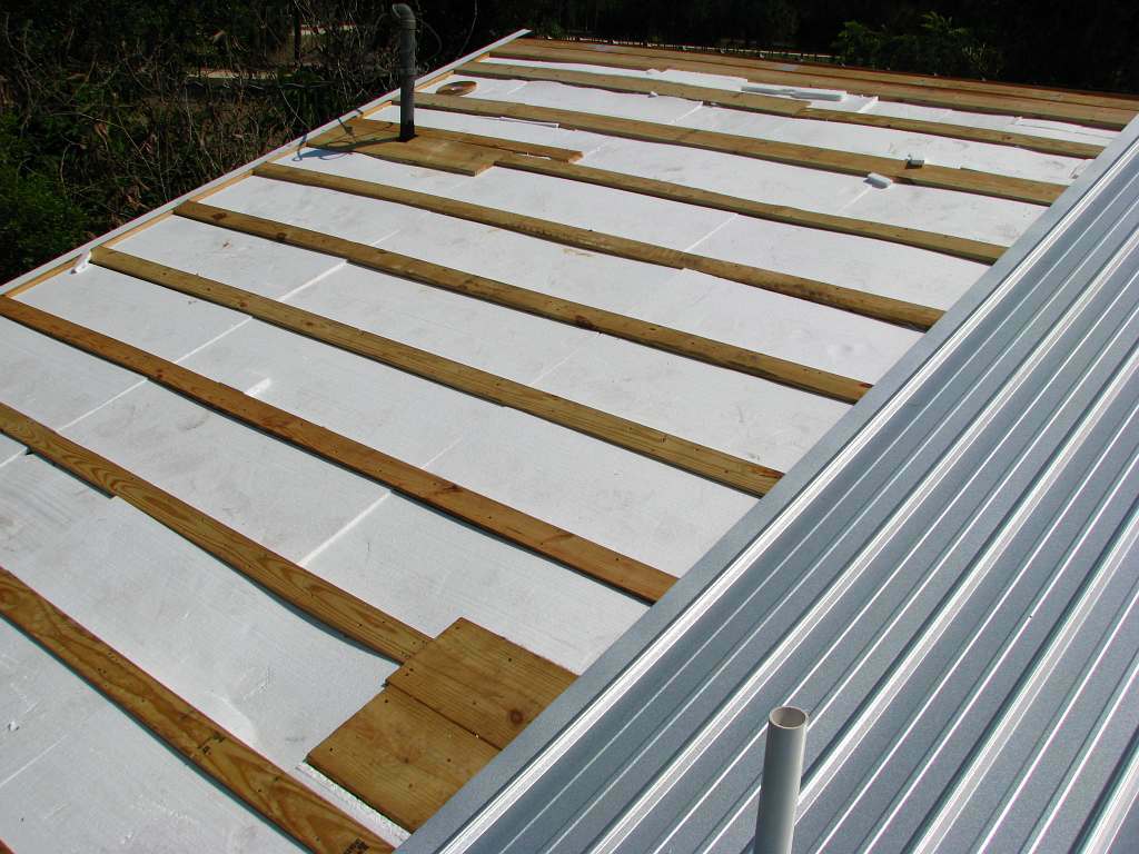

I recently did this house and that of a friends roofing over shingles. This link from FABRAL has some good info.
http://www.fabral.com/technical/Reroof.pdf
Technical Information: Metal Wall and Roof Systems – Fabral

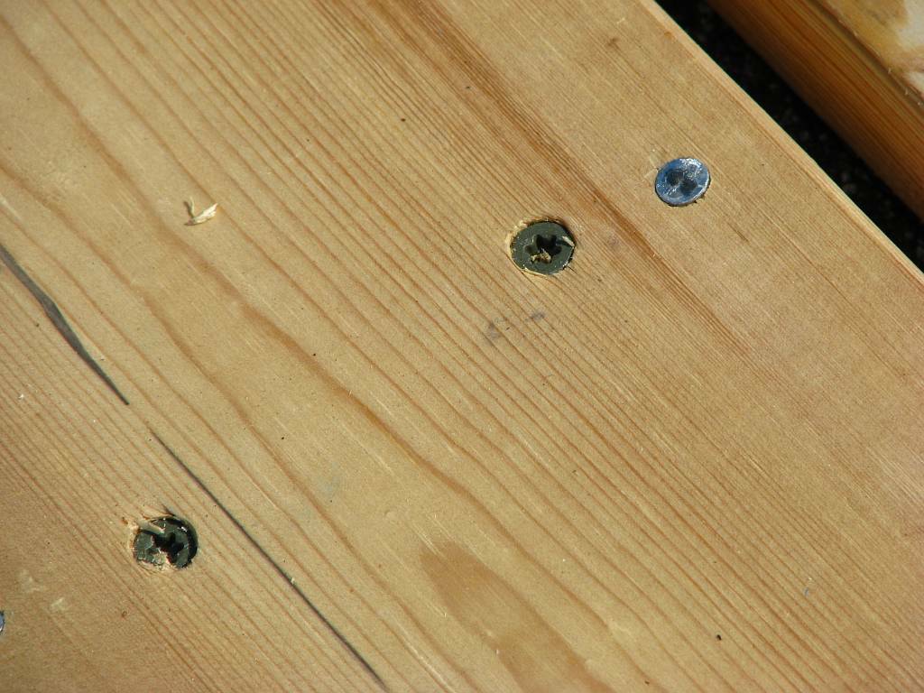

I used 2x4's spaced by the precut Styrofoam for radiant heat rejection (Lowes) that gave me a 17" screw spacing and the screws I used #10 x 1.5" ZAC gave me a wind uplift rating approximately 190+ or - MPH (depending on which engineering study you believe). I used 2x4 purlins to help strengthen the 2' gable end overhang which originally was not built properly and was sagging. Rather than tear the shingles, plywood, and gables off, I chose to use the 2x4's over the plywood and rafters, replacing just some wood at the corners that needed fixing. This also saves in having to rent a dumpster and not needing new tar paper. Because I had 1 layer of shingles and 1/2" plywood, in order to get enough fastener pull out depth on the 2x4's required 4" deck screws at a minimum. Hand nailing with bigger nails than available for an air gun would probably work ok as well in areas not as critical for uplift, but in my location uplift is of prime concern for hurricanes. I used a combination of air nailing and 4" screws for the purlin to truss, and 2-2.5" screws into the plywood between each truss. The plywood was sagging from age (not rot) in between many of the trusses and the 2x4's flattened the roof out nicely. Also got rid of a flat roof that was on the back porch which improved the appearance considerably.
My friend used 1x4's and that allowed for air nailing to be more effective, but we also did extensive screwing with deck screws just to be safe. The 3/4 thickness of the Styrofoam and a 3/4 purlin allows for a somewhat quieter roof during rain due to the metal being in contact with the foam. Using the 2x4 with 3/4 foam allows the metal to make a bit more noise. Finding 1.5" foam is pretty hard, and doubling the 3/4 foam is cost prohibitive.
