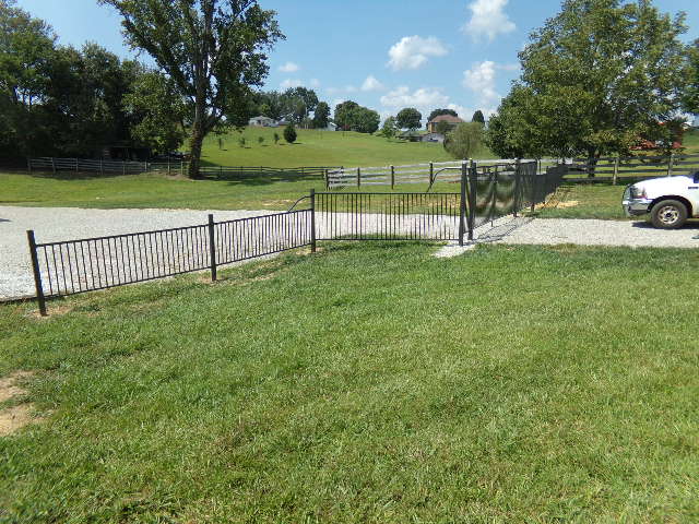

90' up and 30' more to go.

Nice work! Is it a bolt together project or are you having to weld it in place? How are you digging and setting the posts?
   / metal fence installed
The panels are bolt together. Some parts are 6' tall, 4' tall and 3' tall. With panels length from 4' long up to 12' long. All powder coated.
The post on the 6' tall, panels and gates are 1/4" x 4" x 4" and have a 6" H beam cross welded on to the bottom.
For the 3' and 4' tall panels, the post are 1/8" x 3" x 3" with a 6" H beam x 12" long welded on at 90 degrees with the way the fence runs. Then set 24" deep with 80 to 160 lbs of concrete per post.
All the digging was done by hand. One of those jobs that it would take more time/cost more to move equ in and out.

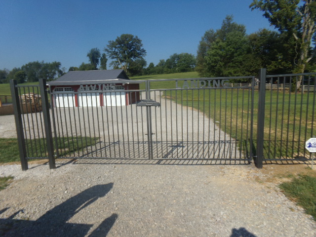

Here is a close up of the gates.

A nice fence really improves the look of a place. How wide is your gate? Most of mine are 12 feet, but when I modified my fence to get my round bales into the horse pasture, I had posts set at 8 feet apart, so I put in my first 16 foot gate and like that width a lot better!!!
The gates are 7' wide each. Total open 14'.

Was this a pre fab set up from a company or something you designed and had built?
She had a AM college class and showup at work in flip flops. That was the only other shoes she had with her.
I designed and built the gates/fence.
