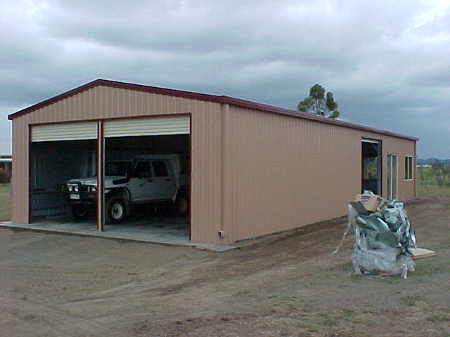

We build almost exclusively in steel for sheds around our parts here.
Steel framing and sheeting. (Steel boxes)
I get scared when I hear what you guys pay for sheds. Seems you don't have the kit process sorted out yet.
My shed worked out at $143/m2 = approx $6.50 US per square foot.
A man's gotta have a shed /w3tcompact/icons/grin.gif
Refer attached.

   / Metal Buildings #8
njrqs,
Was that built or did you build it yourself? Not built the ones I have bought as a kit avg. only about $2.50 a square foot.

   / Metal Buildings #10
Richard
That price was supplied, delivered, erected and concrete slab. Also included all the roller doors, windows, sliding door and insulation. Slab is also 6" thick under the office end.
I am a building cost estimator and find it interesting looking at costs over there.
