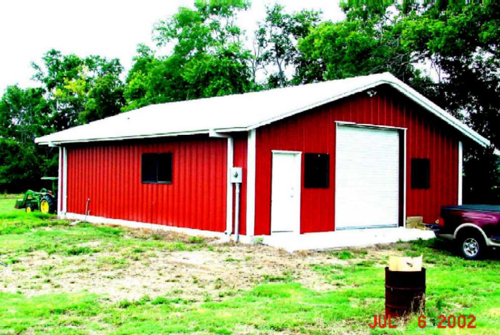

If you were closer to TX I would recommend <font color="blue"> Mueller Steel Buildings </font> . I put up a pre-fab kit 30'x40' 5 years ago that I have been very happy with (see picture). I had a contractor do the concrete slab. I called on some friends to help with the frame and roof panels. All the rest I did by myself. The frame was simple bolt together and everything else went up very easy. They are in TX and neighboring states but I don't think they are any closer to Alabama than Louisiana.

I have been looking at Mueller for metal buildings and was wondering if there anything you would change in your building or anything you wished you would have added?

The basic building kit came with one 10'x10' roll up door and one walk thru door. I bought an extra 10'x10' roll up door so that I could drive in either end or straight thru if I wanted. I also bought two small windows for the front and a larger window on one side. I also bought their insulation kit and guttering. I also added plumbing and put in a bathroom and a kitchen counter with sink since it is on land that we don't live on yet. We sometimes go up and spend the weekend.
The only thing I would do different is put in regular garage type doors instead of the roll ups. The roll ups don't seal off the opening very well and can't be insulated.
