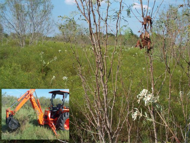

Attached is a photo of our Mesquite in Texas, Is it Gorse?
I had about 8 acres root plowed with a dozer. The dozer pulled a blade that goes about two feet underground.
