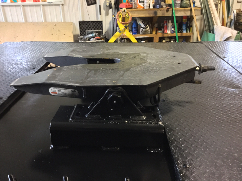

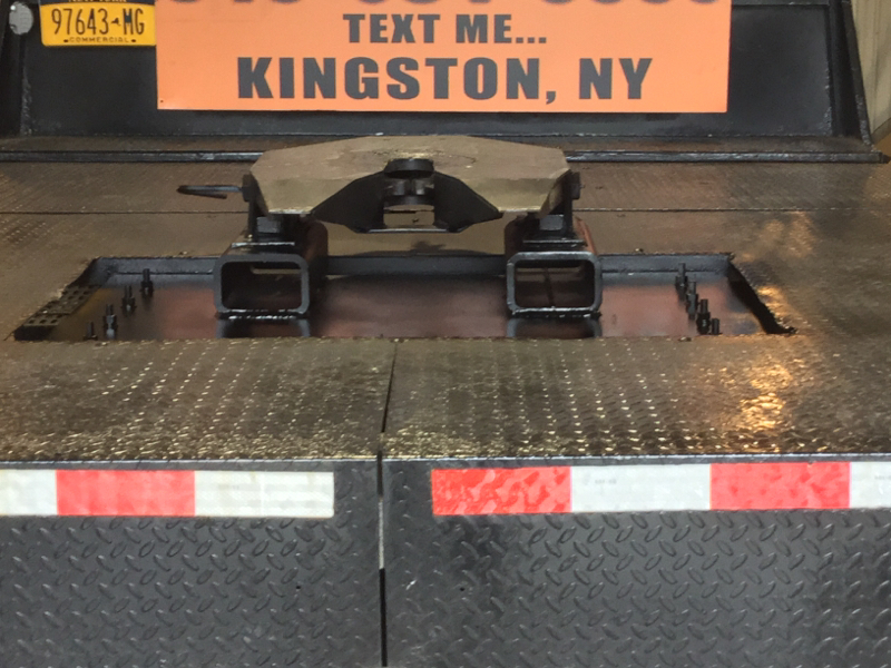

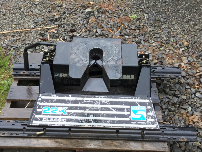

Currently run a 15k Gooseneck Flat Bed with a Reese 22k Fifth Wheel. Am planning on upgrading to a 26k trailer and needed to replace my Fifth Wheel with one that would match the specs of the new trailer. It was a bit difficult finding a fifth wheel that had the vertical load capacity required. My Reese fifth estate wheel was 5,500 pounds. There were some Hot Shot Fifth Wheels I found online that had a load capacity of 30k but had a vertical load capacity of 6k.
I found this Holland F6000 hitch. 32k load capacity and more importantly 12,000 vertical load capacity. This will allow me to load axles equally.
