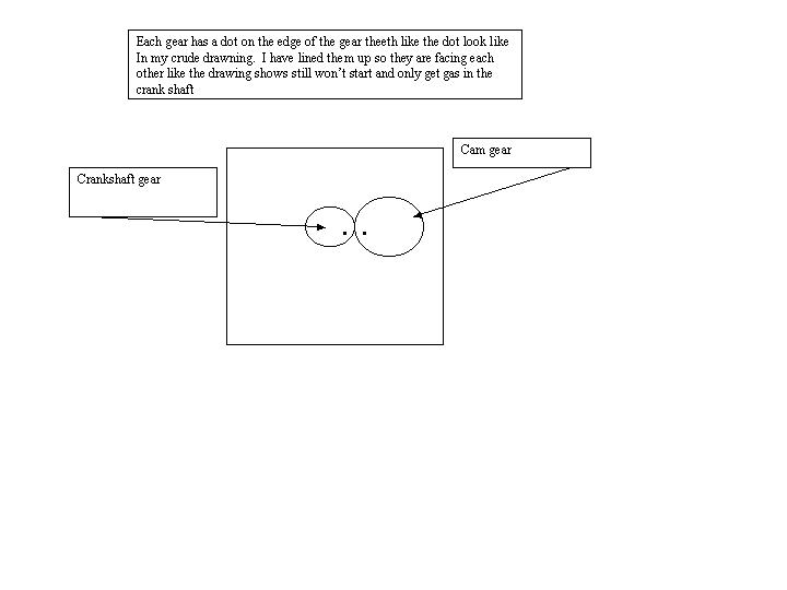

ok got it all back together after spending the last four days on the couch from throwing my back out. what a great way to spend vacation time. I lined the only marks I could find on this briggs and stranton where these little dots on the outside of the gear theeth. they look like drill marks. I lined these up like in the attachment the engine will not start. I get gas in the crankcase and some back fire. I am wondering if these are not the timing marks. I also wonder if the piston rings mights be cause to this. they looked ok so I did not change them. the engine was working fine until the rod broke. I hope I have not confused anyone. by the way the engine numbers are
Model- 253707
Type- 0155-01
Code 83073011

To consolidate the posts.
The cam timing gear has a mark on it. The crank has a mark on it. Cycle the crank around until both valves are closed and the two marks are aligned. That's it on a regular valve engine. The "F" model engines have OHV's so they are differant but no harder.

</font><font color="blue" class="small">( Just to add to Slammer's advice, once you get the dots lined up, rotate the crankshaft & watch the valves. Intake open then close, exhaust open then close. At one point at TDC you should see both the valves opening & closing, when you rock the crankshaft back & forth. )</font>
Molerj is correct, this is called the valves overlapping. Great way to identify each cylinders TDC when adjusting valves.
