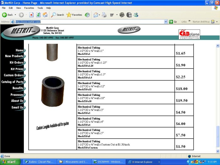

I am thinking of using my KK landscape rake gage wheels on my back blade this winter for snow clearing...
What I would like to do is make some brackets to duplicate what KK supplied, and to weld them on my back blade, so all I would have to do is swing the casters from one implement to the other, and not deal with unbolting/bolting all the time.
Metkit (the CadPlans people) sell what I need, and I may just order it from them. I was thinking (dangerous, I know... /forums/images/graemlins/blush.gif ) I might rather buy a standard length of this stuff, one of pin stock (if that is what you call it) and the other of the tubing, 1" ID, 1.5 OD, 0.25 wall.
I see this stuff is sized so it fits together with a little clearance...
Did a little searching on the net but did not hit pay dirt...McMaster-Carr may have it somewhere in those thousands of catalog pages...
And body have a source of this stuff where it can ordered and sent UPS? What actually do you call this stuff? Perhaps I could find it locally if I knew exaxtly what to ask for...DOM mechanical tubing and round bar stock???
I know it is a simple question! But it is hard to turn the light on when you don't know where the switch is! /forums/images/graemlins/shocked.gif
I've attached a screen image of what I am talking about... I may just order what I need from them, but still would like to know the options for future projects...

A local steel supplier should be able to get drawn over mandrel (DOM) tubing and appropriately sized pins. You may have to buy a standard length (probably 8-10 feet) in order for it to be cost effective. MetKit looks good for small cut lengths.
I don't believe you need a really tight fit because once dust and crud get in there the fork axle won't turn any more. A loose fit would be better in my opinion.
What I am doing for my homemade guage wheels is to use either 1" or 3/4" hitch pins (haven't decided on diameter yet) welded to the wheel forks and using thick walled black pipe for the so called socket. I don't want a too tight fit but I will bore out the pipe on the lathe if need be.

What you are looking for is 1" ID schedule 80 black iron pipe. Look in the yellow pages for a large plumbing supply house or a sprinkler installer. The supply house might just sell it by the foot and the sprinkler installers probably will have a bunch of pieces laying around. The only problem that I have ever encountered is when it is cut with a pipe cutter. This will put a ridge in the end of the pipe that you will either have to file smooth, or cut the pipe with a hacksaw for a clean edge. The bar stock could probably be had from a local machine shop and if you find a small one, they probably will sell you a piece and do the cutting for coffee money. In fact, if you bring a housing to them, they might even do the whole thing for less than you can purchase the materials for. I have a local machine shop that the fellow runs in his cellar. The prices are always good and the service depends on what he is working on. The rush jobs are the high dollar ones and my piddly work he does as fill in work..
