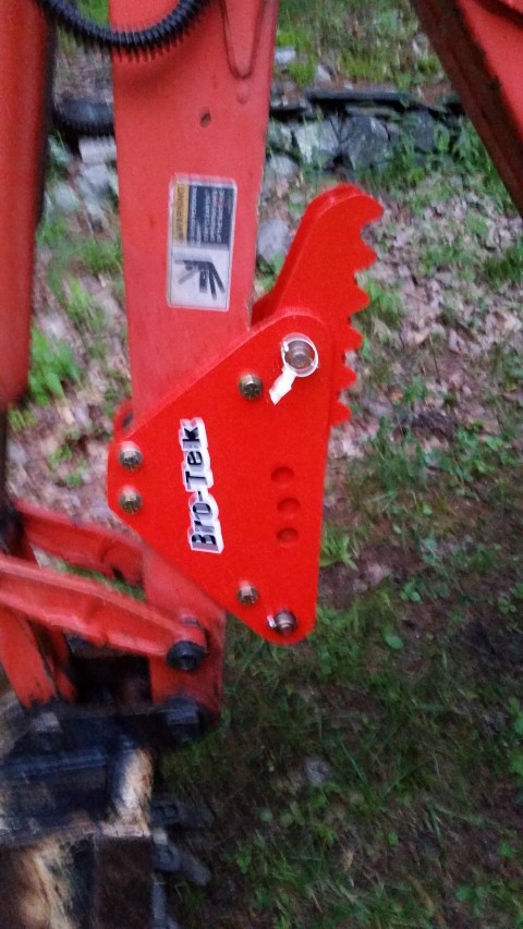

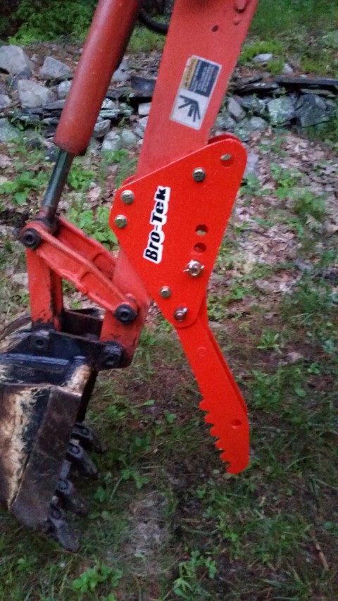

Best I can do now. Getting dark with storms running around.
Stowed:
Extended furthest:
Unseen is the integral "swing arm" that controls where the jaw sits. One user precaution, with the boom fully closed, you cannot swing the jaw stowed or extended. The boom must be out a wee bit or so.
