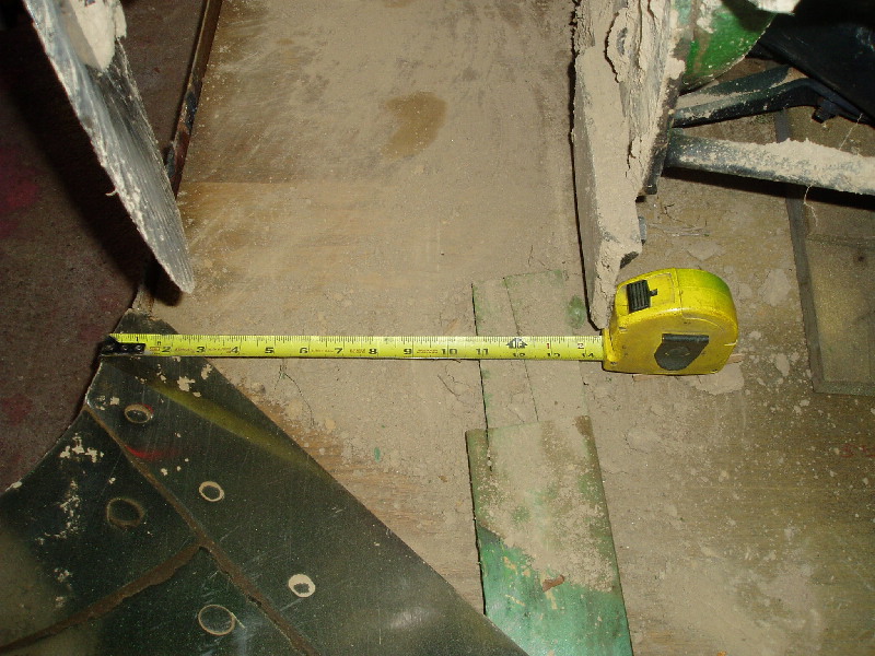

I just bought a set of 3pt hitch plows, hitch pins are cat 2.The guy said they were 18'' ford plows, got them home with a tape measure cant measure 18'' any were. what is refered to when speaking of 12'', or 14'' or in this case 18'' plows.Just for referance the plows stand higher than waist level sitting on the ground.I thought "the" measurement was a horizontal measurment from the point across the width of the lowest part of plow. Or otherwise the width of the cut. Any info is always appreciated.

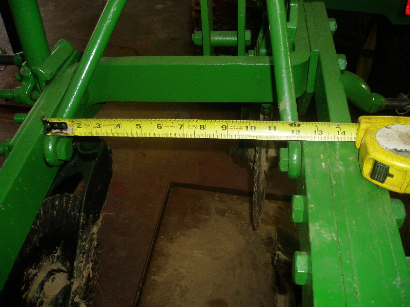

The distance is measured beam to beam.

Measure horizontally from the inside of 1 beam to the outside of the next beam. This will give you ther plow size.--Ken Sweet

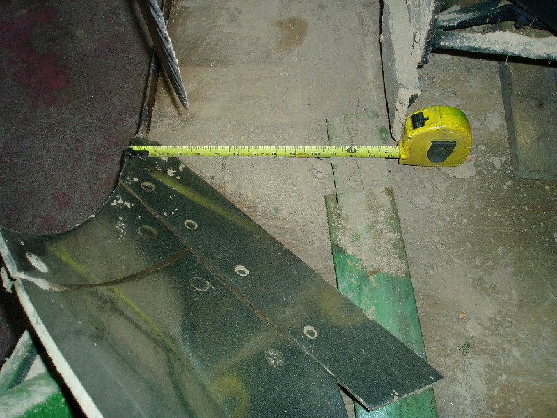

They say a picture is worth a thousand words.... Here's 3000 words.
These are 14" John Deere (model 416A) plows. 2 different ways to measure, both work. Measuring beam-to-beam is simplest.
Picture #1 is sort of decieving. It shows 14-5/5", but trust me, these are 14" plows...

Thanks for the pictures,they are always useful. I was measuring across the face of the "cutting edge" not sure of correct name,instead of perpendiculer like in the last picture.I just went out and measured again and they are indeed 18" plows.If you haven't figured it out yet I haven't played with plows before.Any pointers to setting them up.Trying to get some food plots started.I will be looking at a set of 10' disks tomarrow.Thanks again for the info, this site is very informative.
