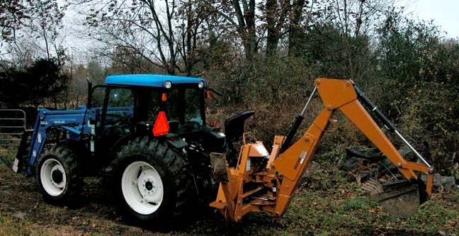

Be careful with what machines you put the 1050 on. It is an excellent hoe. I have a Woods 1050 on my TN75D. It is a heavy Cat II hitch. It is designed for Cat II & III tractors. I also have a 2120 which has a larger frame than the TC45 and there is no way I would put the 1050 on the 2120. It is way too big. the 1050 weights almost 2000#. When I talked to Woods enginering, they told me that the TN or equilavent series was the smallest machines that could use the 1050. I suspect the 1050 could snap the 2120's cases with ease.
Andy
