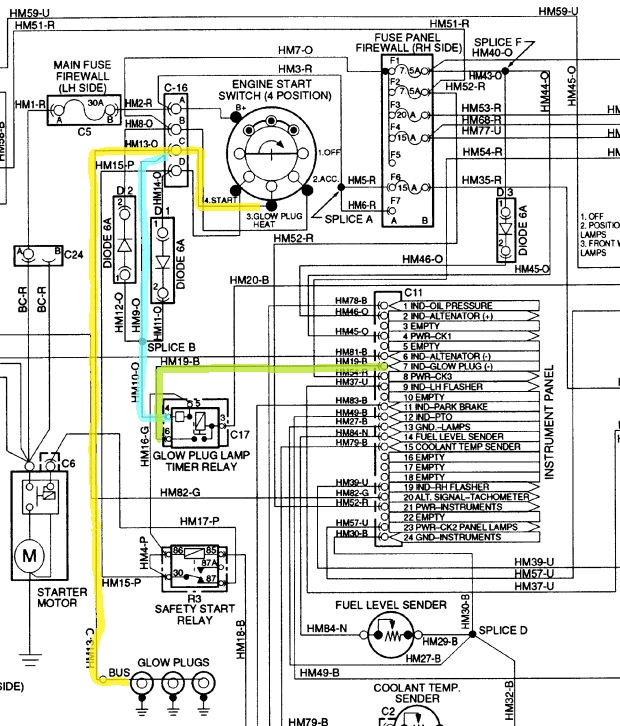

OK fellas (and ladies!), really need your help. My little tractor will not start. A very experienced mechanic and I have been all over this thing for hours; make that days now. We had a bevy of issues, all of which we dealt with as we diagnosed. Starter (new) and battery (new). Glow plug timer (new) as well as one of the three relays.
ORIGINALLY: starter wouldn't turn over. Bench tested it, wouldn't pull in. Replaced starter.
Battery wouldn't hold a load. Replaced battery.
THEN: couldn't get the glow plugs to heat - no 12v to them. Replaced the ignition switch.
Also found problem with the plug that connects the ignition switch into the harness, so we bypassed that. Juice going through switch to the glow plug relay (12v). But from the relay to the glow plugs we only get 1.5 to 2v. Replace the timer relay. Still NOTHING...
Now we are really stumped. At one point, we got a click out of the third of the three like relays (which the parts diagram says is the PTO safety relay). We've swapped the relays around since they are all the same, and even carefully tried the new relay in each of the three positions. No joy. Wearing out the old wiring diagram.

You mention getting only 1.5 to 2V from relay to glow plugs. What if the wire from the timer to plugs is unhooked and tested. If you get 12V then, one or more of the glow plugs could be shorted to ground which is pulling volts down to the 1.5-2 you read.

Being very careful, using a jumper directly from the battery plus to the common glow plug interconnect, hold it there for about 10-15 seconds and then attempt a start.
Glow plugs are nothing but resisters (heating elements) located inside the combustion chamber, well heads, to heat the fuel in order for it to ignite.
Should start and you can always repeat with maybe a few seconds more heat time.
Naturally I assume you follow all the other safety precautions.
Also use a heavy jumper (12 gauge) as plugs draw considerable current.
Another possibility is that the contacts inside the key switch are not making proper contacts which is fairly commonplace.
One cure for the switch is spraying WD40 into the key slot to free up dry lubricant that prevents proper contacting. That is if the switch is the culprit.
Otherwise it might be the glow plug relay module.
