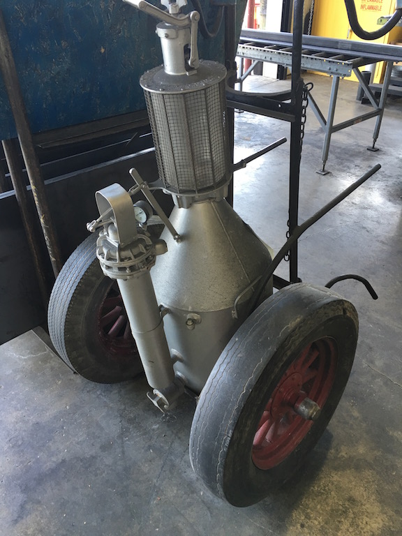

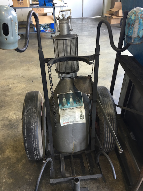

Haven't seen one of these before... found it interesting to examine while I had a few pieces of metal I bought cut at my LWS.

I haven't seen on of those generators for a mighty long time. I took a welding class in high school early 50s and that is how we got our acetylene. My Dad also had one of the portables that we used a lot. It as a huge central station unit. One charge of carbide was 50#. We learned all about acetylene generation and how to maintain the generator. Also miners lamps using carbide were real common back then also. If even allowed anymore the OSHA/NFPA rules are probably pretty onerous. Interesting to see if any welders here still use one.
