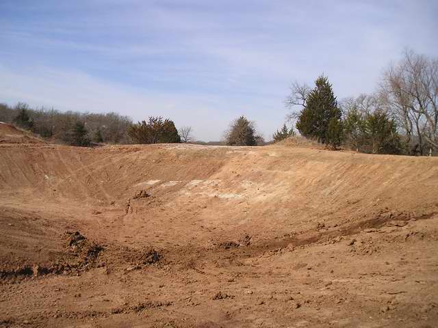

I went up and down these slopes in my pond when I was cleaning up after a dozer. The slopes aren't as long as your hill, but they are sure steep. I carried a full bucket + 1/2 of wet silt up the pond dam with a boxblade on the rear. I could almost make it up in Low-Rabbit, but never had a problem in Low-Turtle. The relief valve on your TC35D is the same as a TC45D. They are non-adjustable and relieve at 5000 psi internal HST pressure.
Your engine may bog down and/or you may be pressing a little too far on the pedal. But if not, I would wonder about the relief valve. There are actually two valves, one for forward and one for reverse, both the same. They can be changed without disassembly of the tractor.
