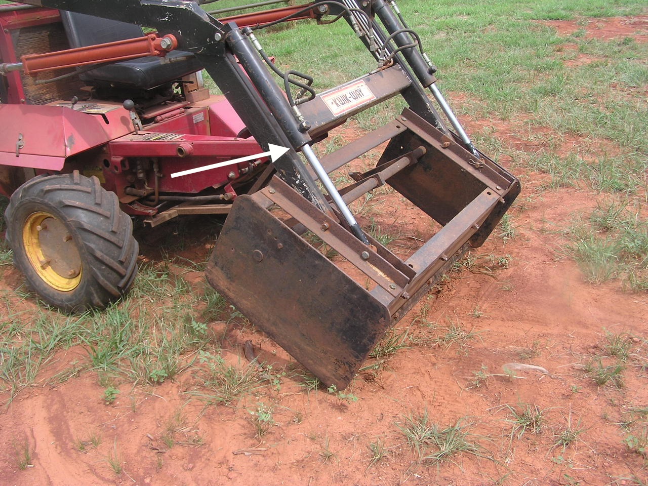

Note the clearance where the arrow points, between the rod end of the cylinder and the loader arm.
The clearance is different, depending on the pivot pin to rod pin spacing.
