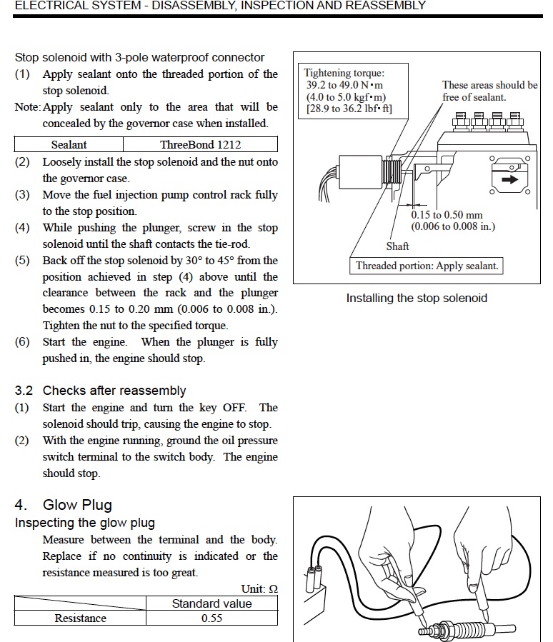

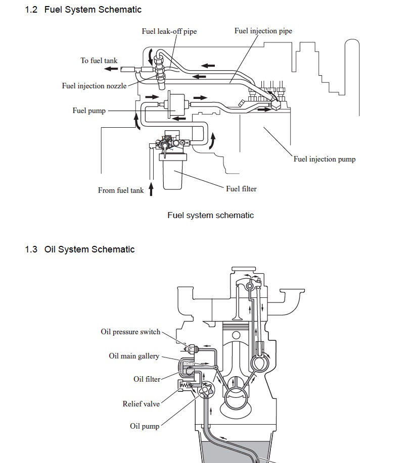

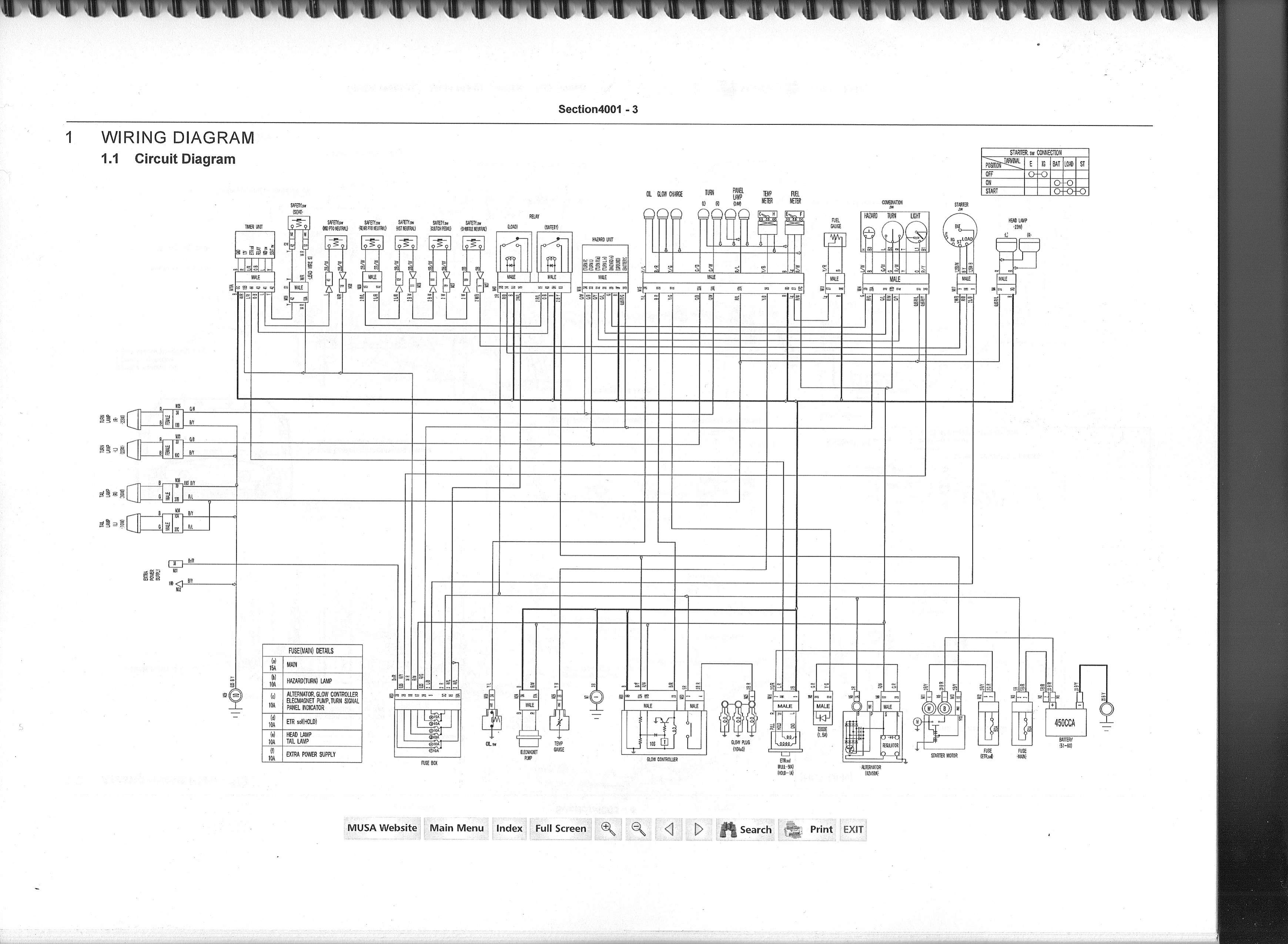

When I was trying to figure out what was going on I came across the service manual for the Mitsubishi SL3 motor which is what's installed in my tractor and a number of other Mahindra models and thought I'd share a couple pages on the procedure for installing the stop solenoid and a couple
of schematics. Might help the next person who does a search
