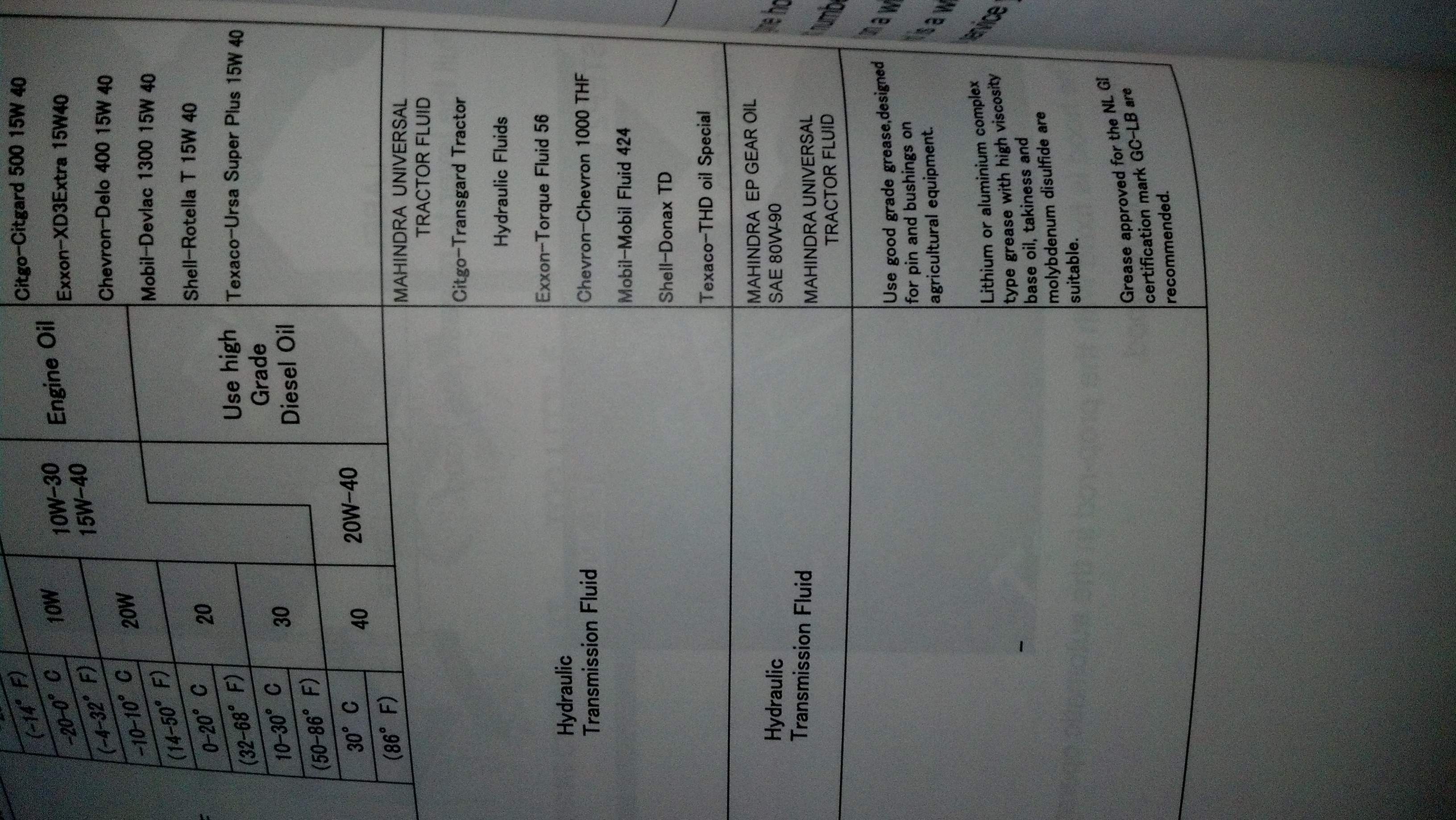

My owners manual states several types of hydraulic fluid for the transmission and 2 Mahindra only fluids for the front diff. I would like to get the fluids at TSC or an auto parts store. Of all the types listed, I have not found any of them. What do I need to look for?
I will try to attach a pic of the page in the manual.

Hytrans, such as the Chevron THF is good in the tractor and also in the front axle of the Max series. We use the Mahindra HyTrans as we are a dealer and find it cost competitive anyway, but any major brand such as Chevron, Texaco, Mobil or whatever that is rated properly is surely fine. I would not go with the discount re-refined stuff. You have a high precision HST unit and it needs proper fluid....not just anything slippery like we could do on the old tractors!
