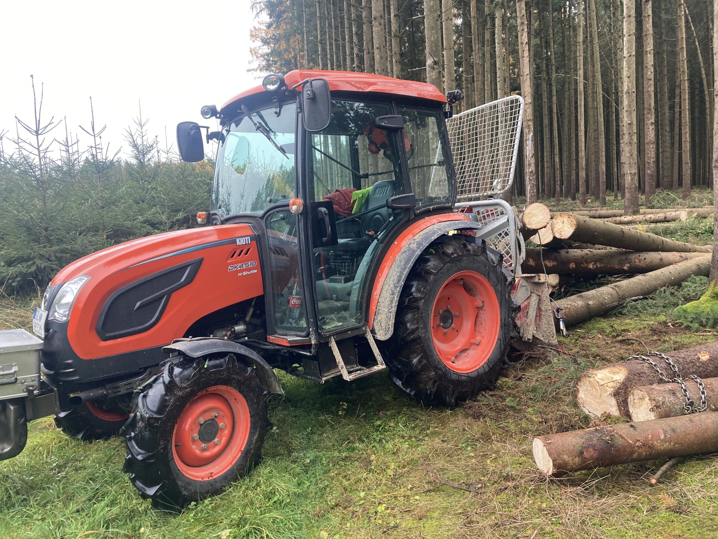

Hello,
i own a dk4510hs made in 2017 which was still imported from leeb austria into germany,
the registration docs show a maximal admissable trailer mass of 3500 kgs, braked, only!
the dk4520 has 5500 kgs !
any forum members from europe or even germany who could check their dk4510 values?
thanks a lot

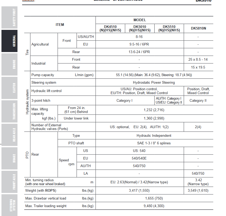

Hello,
Nice looking tractor you have there.
I was checking the service manual and turns out they list 4300 kgs for the DKxx10 series.
