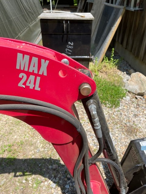

Anyone build a bucket level rod for a Max 28?

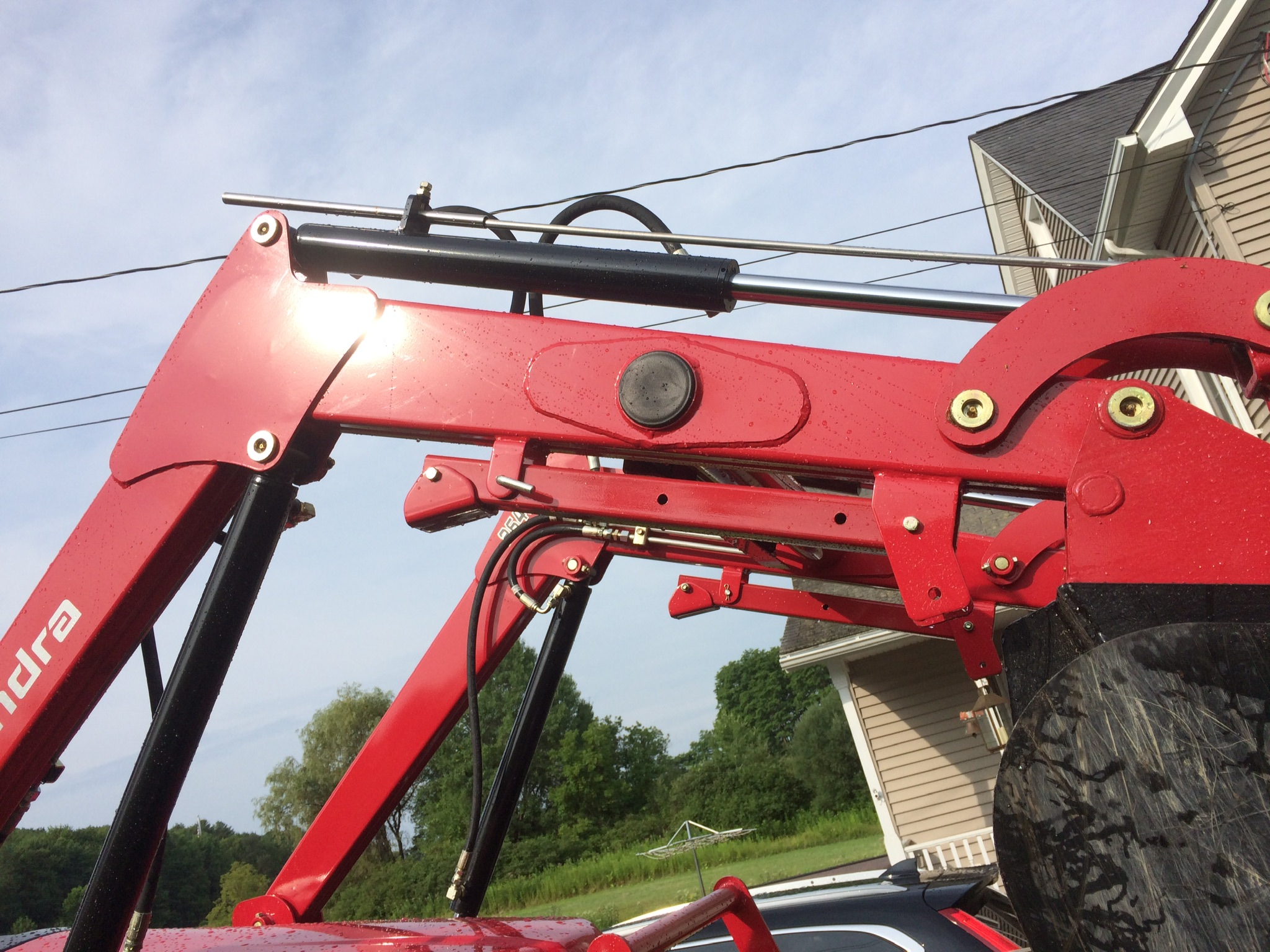

Here is the set up on the bigger Mahindra tractors.

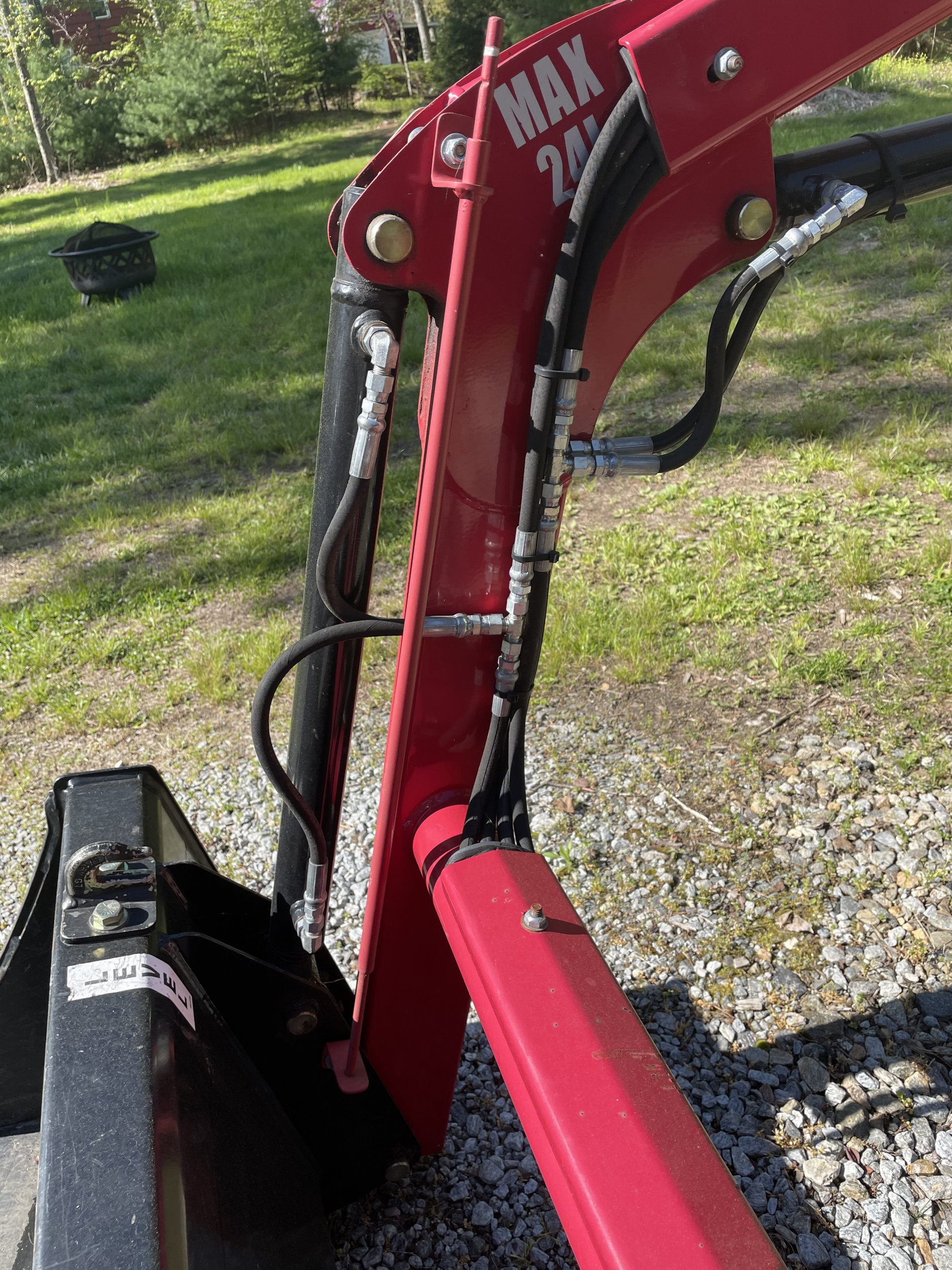

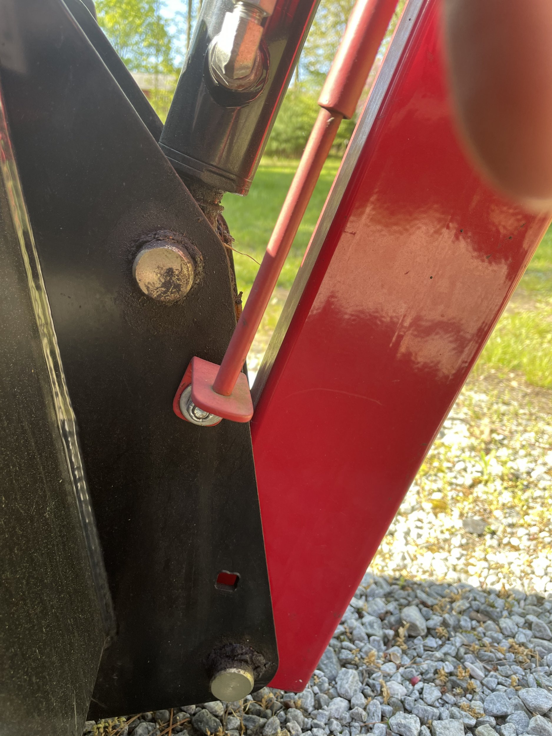

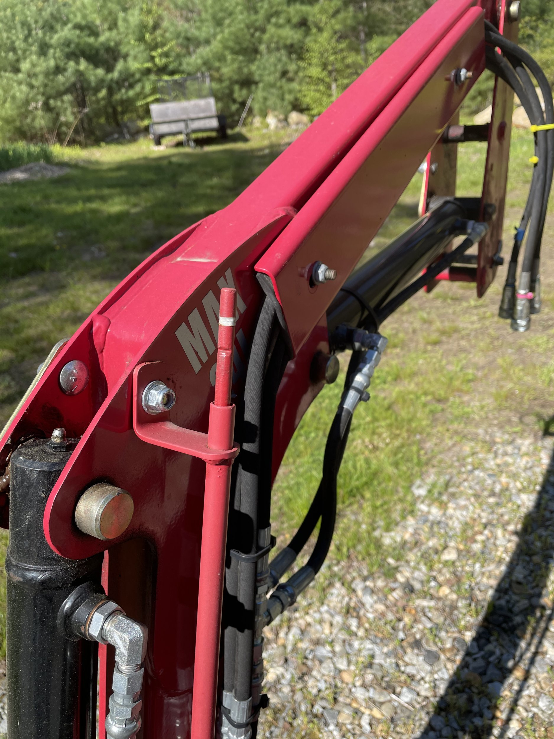

Here are some pictures of what I I’d. Don’t recall the sizes, but got the tubing,rod and flat stock at tractor supply. Drilled the holes in the brackets,bent them in a vise with the help of a propane torch and the rod and tube were put into the bracket holes and tack welded. After marking the rod with the bucket level, I ground a groove and painted white so the paint wouldn’t wear off. all of the holes on the loader were already there. I made a plastic bushing for the upper hole to match the bolt size. Also want to use nyloc nuts so you can leave the brackets a little loose so they rotate.

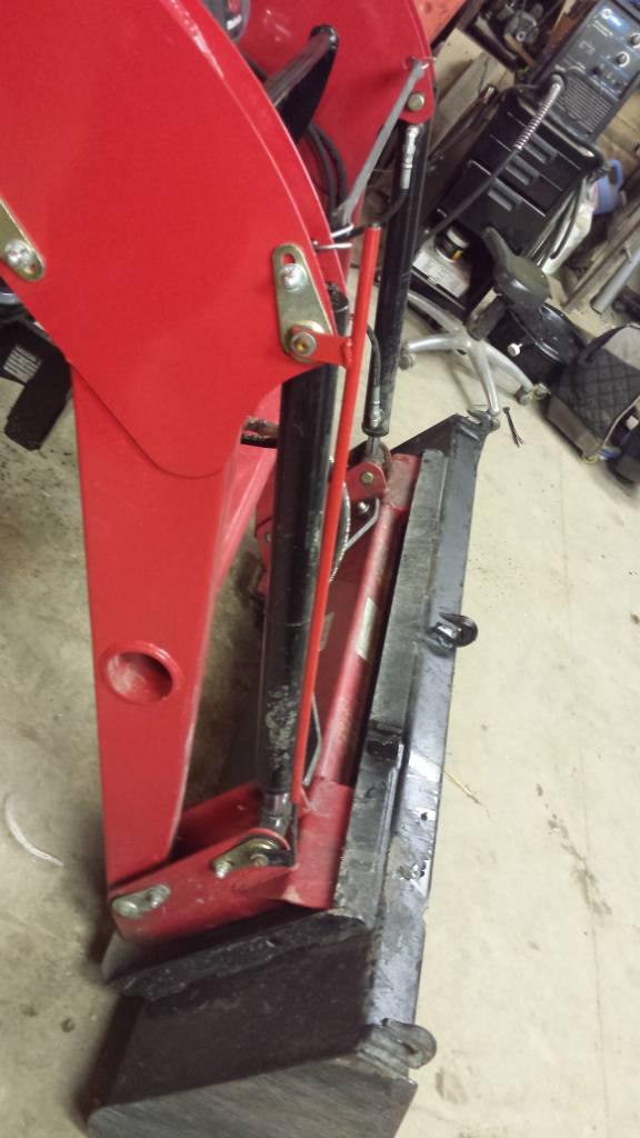

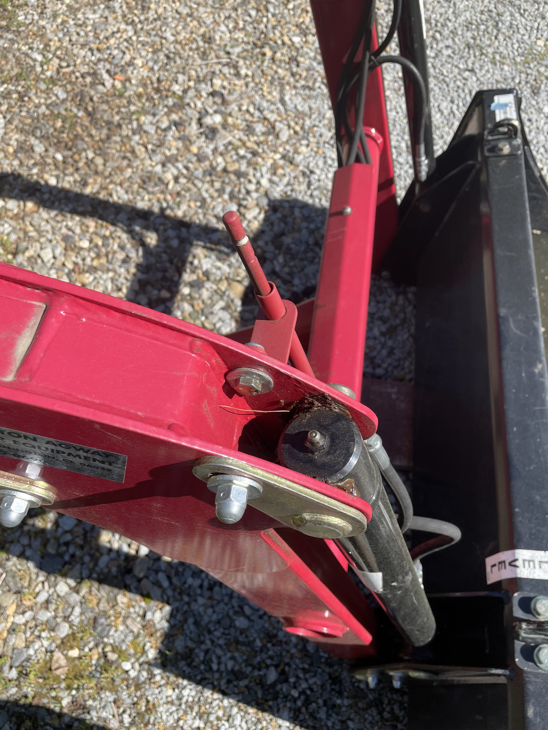

   / Max 28 Bucket Level Rod #8
This I what I did on my 3616. Drilled and tapped the pins to 5/16 thread and used 3/8 shoulder bolts.
That was what I’m looking for! Thanks! If you get a chance can you measure that rod and tube? thanks again!
I don’t see where the plastic bushing goes?
