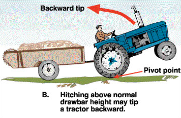

Does anyone know how much weight a Max 26 can safely tow around the farm? I have a dual axle dump trailer I want to move around the farm that weights 2000 lbs empty using a 3 pt quick-hitch with ball mount attachment. I would never be crazy enough tow it loaded, but would like to move it around when empty on some 8-10% grades. Every internet search results in "towing the tractor on a trailer" and not "towing a trailer with a tractor". Cant find anything in the Specs. Hopefully someone can solve this puzzle or has a good rule of thumb (% of tractor weight, etc). Thanks !!

Also, there are pitfalls to using the 3 point hitch to tow trailers. A negative tongue weight will raise the hitch, and can be higher than the tractor's center of gravity. Most recommend (including likely ALL manufacturers) only towing from the drawbar.

Any time you are pulling a load with a tractor, the load is trying to pull the tractor over backward. The Three Point Hitch relies on "tongue weight" (mass of the load bearing down on the Lower Links) for vertical stability. The Three Point Hitch does not include a latch to prevent unanticipated upward movement of the Lower Links, cross-drawbar and a wheeled load.
Sudden reversal of tongue weight may occur as single axle cart load is pulled up a slope, over uneven ground, if a cart is inadvisedly loaded at the rear first rather than the front or center first, or if someone steps on rear of the load, shifting weight distribution to the rear. Caution with two-wheeled drawn implements is also advised, for identical reasons. The potential for load upset, tractor upset and human injury is there.
The Three Point Hitch and optional cross-drawbar are designed to pull heavy loads at or below rear axle height, over level ground, with minuscule risk of a backward upset. When the cross drawbar is raised above rear axle height, the potential for a backward upset increases. Always position Lower Links and cross-drawbar at the level of the rear axle or as low as conditions permit.

Jeff9366 has explained the situation clearly and correctly. The PROPER way to pull a load is with the drawbar since the drawbar is mounted below the center of rotation which is the axle center. I know a person who incorrectly hitched up a heavy load, higher on tractor than proper mount point, and tractor pivoted about the axle and flipped over backwards, killing the person. Happens so fast the operator was still in the seat for the entire ride.

When I was 11 years old, I saw an accident where the tractor tipped over backwards onto a loaded single axle trailer that was connected to the 3 point hitch. It wasn't a sight I wanted to see at that age.
Please don't ever consider pulling any object with the 3 point hitch unless it is designed for ground engagement.
