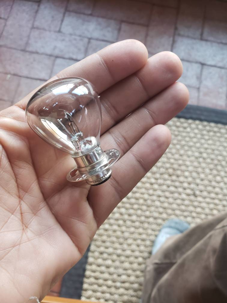

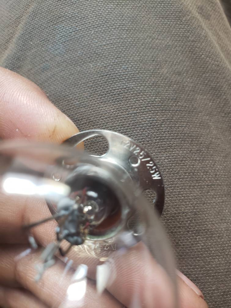

Does your bulb look like this and have the following description on the flange? 12v25/25w. My tractor is a 3316 hst, model year 2011.
I ordered a pair of bulbs that matched the description but did not have the correct flange for installation into the socket. If your bulb looks like mine, I would be curious to see what this thread reveals about a replacement, either incandescent or led.
You cannot get this bulbs at any local auto parts type places.
   / Max 26 headlight bulb #5
View attachment 719387View attachment 719388
Looks like an older style snowmobile headlight bulb....

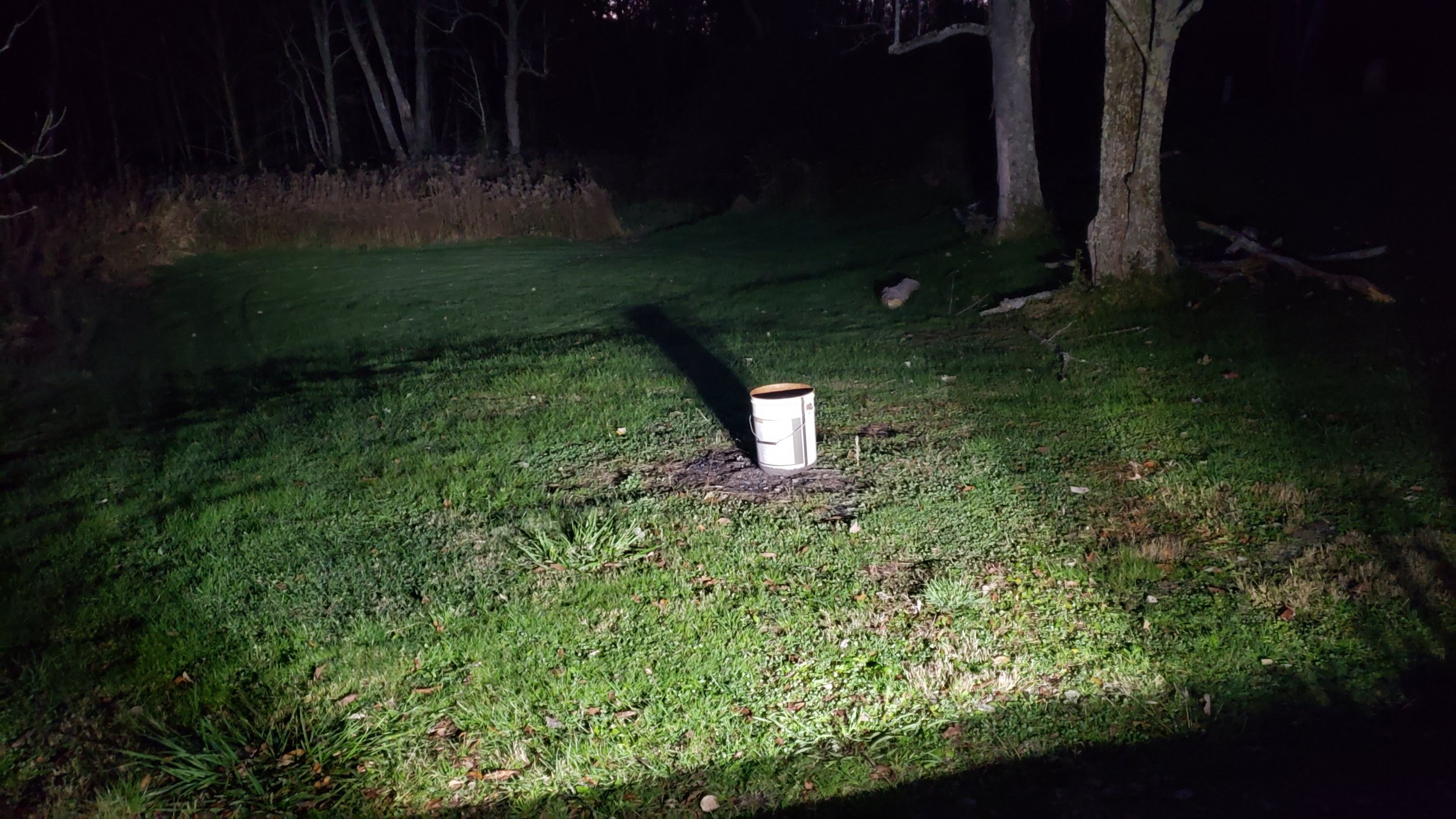

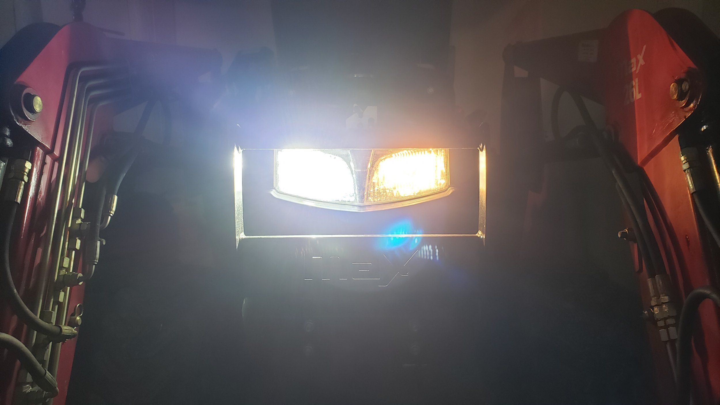

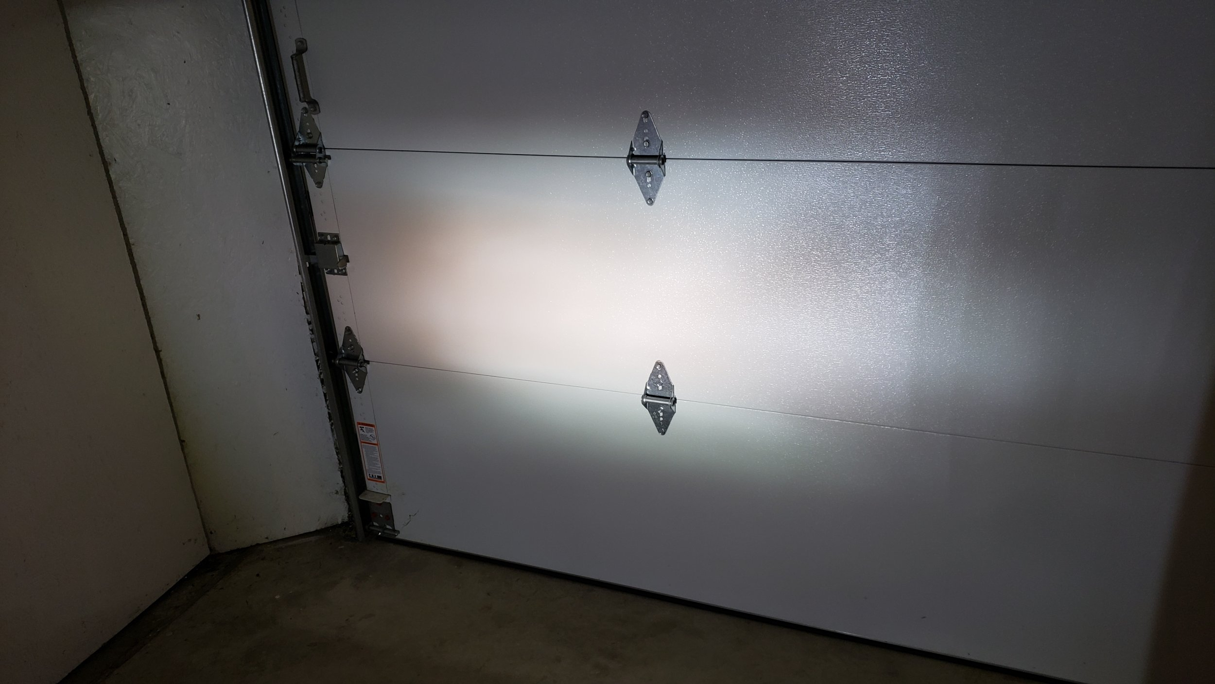

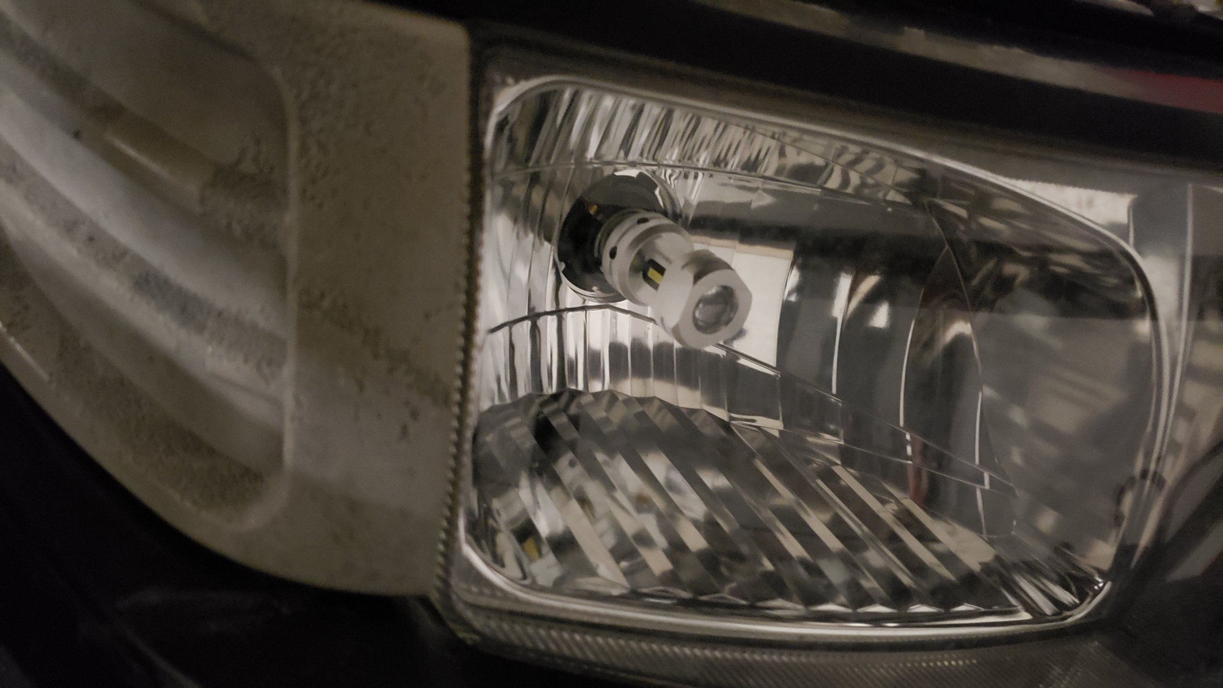

for those interested, its a 1073 bulb, dealer wants 25 bucks a pop, they are 6 bucks for 2 from the auto store..... I will just leave that there.
ordered these hopefully they are better.
came in, substantially brighter, camera doesn't do justice, feels like car headlights now, bit on the cold side (6000) I prefer 4000-4500 color temp. worried i might get blinded lifting the bucket, but I don't. hopefully they last
