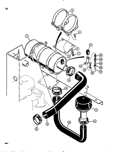

Dang it Solinski, now Im on the hunt for a pre cleaner as well. The intake on the Kubota is straight down and Im thinking that your Mahindra is the same? I found a pre cleaner that uses a "U" shaped hose and I wonder if a set up like that would work. My concern would be dust and such would get in the bottom of the "U". Any one else care to pitch in?
[Parts for Case 1845 Uniloaders/Skid Steer Loaders
ATTACH=CONFIG]315366[/ATTACH]
  • CASE-1845-AIR-CLEANER-AND-PRE-CLEANER-MOUNTING-PARTS-MACHINES-WITH-GASOLINE-ENGINE-02zR-normal.gif

Hi Steve, Thanks for posting the diagram. Is part #2 a centrifugal or static precleaner ? Looks like its mounted below engine level ? What year and model Kubota is this OEM diagram ? 90 degrees here in Redding yesterday. It is very dry hot and dusty, I am anxious to install a centrifugal precleaner! The air filter element on the Mahinrda Max 25 is $44.00 ( Mahindra says 10 cleanings and replace it) and so far I have not been able to cross reference an after market replacement from to Wix, Baldwin, Fleetguard, etc. On my very long project list is replacement of the OEM single filter housing with a dual element style, but that is another story.

Hi, back again, sorry I'm late. No, that is not a centrifugal pre-cleaner in the diagram just a normal Donaldson style one. I havent been able to find a small centrifugal style that will work with the Kubota. Another problem is my tractor is a gear drive and I dont need to keep the RPM's up like that of a HST tractor to spin a centrifugal pre-cleaner. The only time that I keep the RPM's up is when mowing so thats out of the picture. I was surprised on the amount of dust that the air filter traps and thought a pre cleaner would help keep a bunch of dust and such out of it. I'm lucky as there is enough room under the hood to make some sort of a pre- cleaner work. I dont know what the application is in the diagram but that is basicly what I have in mind to do to the Kubota. Any chance that you can post a under hood picture of your tractor? Ya never know, some one here might be able to come up with a clever idea to keep you from cutting a big hole in the hood of your new tractor. A person has to be real careful when blowing out a air filter so not to damage the paper and make a nice little hole for dust to get into the engine. Wow, $44.00 bucks for an air filter? I think mine is around $20.00 dollars and its is available aftermarket. I would contact some one like Baldwin and give them the size of your filter to see if they have anything that size. Redneck in training posted a good site on pre-cleaners so maybe they might have some ideas as well(????????)
Steve
